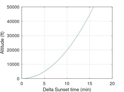

Posts: 9938
Re: Visible by Height
08/05/2021 11:18 AM
Sunset is defined by when the upper edge is on the horizon.
What is the definition of sunrise/sunset and moonrise/... | Old Farmer's Almanac
Formula for distance D to the horizon (in miles) at altitude h (in feet):
D = 1.2246 * sqrt(h)
(This formula assumes a parabolic approximation to a circle, very good at relatively small elevations relative to earth radius.)
If you were on the equator, 1 degree of longitude = 69 miles. So moving 69 miles toward the setting sun results in one degree increase in elevation of the sun.
Given your elevation in feet, calculate the distance to the horizon in miles and divide by 69 to get the sun's increase in elevation in degrees. This is the same as the degrees below the horizon at ground level.
10000 D=122.46 miles Deg=1.77 deg
20000 D=141.42 miles Deg=2.5 deg
30000 D=212.1 miles Deg = 3.074 deg
40000 D=282.92 miles Deg = 5 deg
08/05/2021 4:52 PM
So there would be a window of sunlight stretching around 3000 ft from just visible to fully visible, rising at around 3000 ft per minute....?
Posts: 9938
08/05/2021 9:37 PM
In #8 we are connecting sun elevation (in degrees) with altitude at a fixed time just using geometry. If you put 'time' into the equation, it gets a lot more complicated.
The sun "moves' 15 degrees per hour or 4 minutes per degree, but its path is only perpendicular to the horizon at the equator during an equinox. The angle of its path with respect to the horizon is a function of both time of year and latitude. Near the arctic circle, the time it takes to drop 1 degree below the horizon is measured in days.
The sun elevation changes linearly with time, but the "sunset altitude" increases as the square of the elapsed time. The second plot shows delta time on the equator/equinox. At other times and places the elapsed time will be longer. (Sunsets are noticeably more rapid in the tropics.)
Scaled to Equator/Equinox
