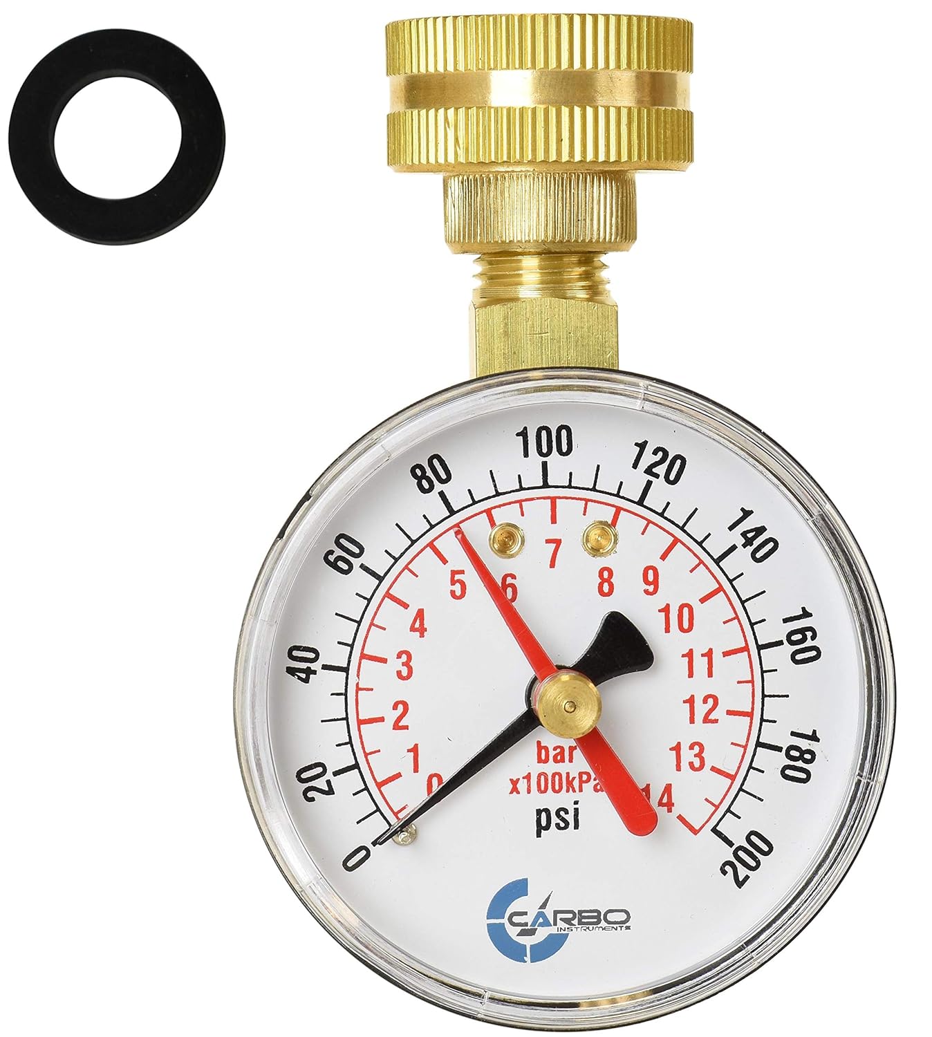

Re: Pool Fountain Acting Strange
08/14/2021 2:13 PM
Here's another thought...
Get a water pressure gauge. I just bought one from Amazon for about $13. It has a garden hose connection, so you also might need to get an adapter or find a gauge with the right connector to match your water jets.
When the jets are running, you can estimate the pressure by the height the water sprays up into the air (the head). If you replace the jet with a gauge, there is no water flow. If the loss of pressure is caused by obstruction, you should see a loss of pressure with the jet in place, but not with the jet replaced by a pressure gauge. If the loss of pressure is caused by a water leak, you should see a loss of pressure in both cases.
