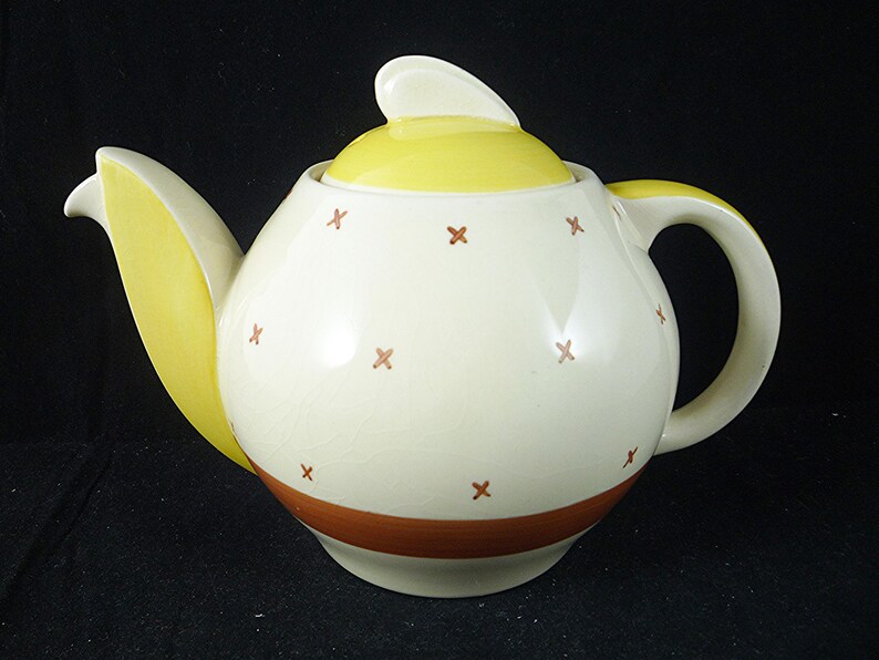

Previous in Forum: Parasitic Brain Control   Next in Forum: 10,000 times faster than living synapses
28 comments
Teapot terminology
08/03/2022 5:21 AM
I realise that tea and teapots is not likely to be of interest to many over the pond, but perhaps the terminology may be common to other vessels.
I have quite a good teapot:-
It's a Le Creuset which is quite a good make, but, it suffers from a major fault. Tea leaks from the front of the lid as soon as you start to pour both when the pot is full and when the spout gets blocked by the tea bag.
I have seen pots with the following design change (I have just badly edited the picture):-
The lid has a complementary change: the lid is still round but the bit which projects into the opening is "just over semi-circular".
What is the name of this type of change so that I can search for one.
I've done searches for: teapot images, teapots with semi-circular lids and several others.
I found these
the anatomy of a teapot
teapot shapes
I thought this would be easy, but haven't found anything yet.
I suppose in desperation I could try to modify my existing pot.
Any ideas?
Re: Teapot terminology
08/03/2022 8:54 AM
I googled ‘Where Are Le Creuset Teapots Made’. Le creuset stoneware is safe for use in the microwave, freezer, refrigerator, dishwasher, oven and broiler. Hence, “made in china” le creuset products are safe if they are made after 1970.
I didn’t go to the site,… I felt that it was questionable. My point, is if manufacturing is offshored, maybe the design of it have also been cut.
Re: Teapot terminology
08/03/2022 9:57 AM
I'm pretty sure they are still made in France.
In any case teapots are one item I would expect the Chinese to be pretty competent at designing.
Re: Teapot terminology
08/03/2022 10:56 AM
I would think so….
Join Date: Dec 2020
Posts: 75
Re: Teapot terminology
08/03/2022 9:10 AM
The answer is much simpler and it was solved millions of years ago by the Japanese which you can demonstrate to yourself reading this article and then buy a small jar of Kikkoman soya sauce to prove it for yourself before doing what I'm suggesting here.
Drill a hole or cut a notch in your lid and always position your lid so the hole or notch is always farthest from the spout, so 180 degrees away.
That lets air get in and it will stop the blockage of your pour which is causing your pot to be tipped higher than it needs and then there will be no leakage from the lid.
Why soy sauce pourer works
Re: Teapot terminology
08/03/2022 9:50 AM
As it happens the lid already has a hole there at the back by the lip designed to stop the lid from falling when tipped forward:-
The marketing blerb describes it as a steam hole.
In any case the blockage is caused by the teabag entering the spout.
Join Date: Dec 2009
Posts: 916
Re: Teapot terminology
08/03/2022 9:40 AM
I steep my tea in a nice little Susie Cooper teapot from Crown Works, Burslem, England (circa 1930's). It suffers from neither of the pouring defects you describe. It is a spherical, rather than cylindrical design. The interior seven strain holes leading to the spout are positioned on a convex surface so that the tea bag slides to one side of the strain holes when pouring, leaving the holes unobstructed. The tumblehome (nautical term) top prevents the tea leaking around the lid when pouring. These well considered design details contribute to the pleasure of the tea drinking experience.
Re: Teapot terminology
08/03/2022 10:29 AM
This sounds something like I was thinking, an internally curved strainer that would block the teabags while not allowing them to cut off the flow of tea to the spout....I looked for one online but couldn't find what I was looking for....
This design is an alternative, but might not align with your present routine...however it does show an insert into the spout that if modified could work...
Join Date: Dec 2009
Posts: 916
Re: Teapot terminology
08/03/2022 1:23 PM
Susie Cooper had it all figured out 90 years ago. Her teapots can still be purchased from antique dealers.
Re: Teapot terminology
08/03/2022 11:53 PM
Re: Teapot terminology
08/03/2022 10:50 AM
I think you are looking for a locking or latching lid teapot.
Speaking of teapots, there was a presidential scandal on this side of the pond a century ago involving a Teapot.
The more things change the more they stay the same.
Location: Stoke-on-Trent, UK
Posts: 4499
Good Answers: 137
Re: Teapot terminology
08/05/2022 11:26 AM
And there was something about tea (but not teapot) in Boston about 250 years ago.
Re: Teapot terminology
08/03/2022 4:15 PM
How about pulling out the bag(s) before pouring the tea? Or use loose tea in a metal ball, which stay at the bottom.
Posts: 1058
Good Answers: 88
Re: Teapot terminology
08/04/2022 12:53 AM
An engineer would find a way to keep tea bags submerged. How about attachable ballast on tea bags? (LOL) S.M.
Re: Teapot terminology
08/05/2022 11:04 AM
I could make a simple wire teabag holder: GA
Re: Teapot terminology
10/17/2022 8:27 AM
I made a simple cage out of a length of piano wire
But I was surprised that when it came out of the dishwasher it was really rusty. (Pianos must be really difficult to maintain in high humidity climates.)
So I bought a small one of these stainless steel infusers.
It worked but it was difficult to cram the teabag into, so I've settled for one of the medium ones (about 2" diameter).
Join Date: Mar 2009
Location: Sydney, Australia.
Posts: 126
Good Answers: 11
Re: Teapot terminology
08/04/2022 2:23 AM
I have an ~20 yo Avant double wall teapot with strainer and it's the best teapot I've ever seen - tea stays hot i.e. the second cup is as good as the first. They seem difficult to find in Australia these days (and my model doesn't seem to be available now), so online appears to be the go. I found this model online which appears to be the latest version of mine:
Avanti Modena Double Wall Tea Pot, Silver, 15137
here: https://www.amazon.com.au/Avanti-Modena-Double-Teapot-Stainless/dp/B077K69STS
I couldn't recommend this style of teapot more highly.
The only problem I've had is snapping the handle off while getting to vigorous with the cleaning and had to get our guru TIG welder to repair it 10 years ago, so a word of warning.
BTW, give leaf tea a go, it's so much better than teabags.
Cheers
Re: Teapot terminology
08/05/2022 11:17 AM
Seems like double wall and infuser is the way to go, but I can't find that model here (UK), and its out of stock in Aus. Also the box picture shows it as 600 ml whereas the description says it's 1200ml.
Don't know why I can't post pictures at the moment: all the editing functions have vanished.
I'll probably go for this Cafe Ole 1.2L spherical with double wall and infuser. Can't even post a link.:
https://smile.amazon.co.uk/Grunwerg-Cafe-Ole-Rondeo-1-2l/dp/B01N5NMH6Q/ref=sr_1_5?crid=1HME2WH3GS2EB&keywords=double+wall+teapot&qid=1659600860&sprefix=double+wall+teapot%2Caps%2C87&sr=8-5
Join Date: Mar 2009
Location: Sydney, Australia.
Posts: 126
Good Answers: 11
Re: Teapot terminology
08/05/2022 9:42 PM
Bad luck about the Avanti's availability. I struggle to understand why such a brilliant product is so hard to get hold of. I've seen them in Mogo (NSW South Coast) and Geelong (near Melbourne) while on holidays but haven't bought a spare yet. Note to self now to buy the next one I see. Cheers
Location: Stoke-on-Trent, UK
Posts: 4499
Good Answers: 137
Re: Teapot terminology
08/04/2022 7:32 AM
Seems an odd design for a teapot, the lid being nearly the same diameter as the body is asking for the problem you're getting. A traditional teapot has a smaller lid (as I'm sure you know). I live near Stoke-on-Trent, once the teapot capital of the world! I'm sure there are plenty available in factory shops, if you're up this way and thinking of a new one. Big decision, I know
Posts: 1395
Re: Teapot terminology
08/04/2022 10:13 AM
I would call that modification a dam, if that’s any help. Seems like someone might have thought of it before, but someone has to be first, maybe it is you!
Re: Teapot terminology
08/05/2022 7:47 AM
After all this, does anyone fancy a cuppa?
Re: Teapot terminology
08/06/2022 4:55 PM
Lapsang souchong for me, please! A smoky, robust, manly tea (mentioned in James Michener's Centennial).
Location: Stoke-on-Trent, UK
Posts: 4499
Good Answers: 137
Re: Teapot terminology
08/07/2022 2:47 AM
Why do Marxists like Earl Grey tea? Because proper tea is theft.
Re: Teapot terminology
08/08/2022 9:17 AM
Earl Grey - perfect for a summer's afternoon when one finds 20min in some shade and somewhere to sit quietly. A splash of milk and one sugar, please.
Re: Teapot terminology
08/08/2022 11:09 AM
I like green Earl grey, but you seem to need to pay an arm and a leg for it now.
Posts: 276
Re: Teapot terminology
08/09/2022 8:56 AM
We've been here before. I used to have a design that appeared in a book by Eric Laithwaite, but it has disappeared and I can find no reference to it on the internet ( I had a dispute with my son who said you don't need to keep those old reference books and encylopardias, you can always find it on the internet, - ha ha).
It dealt with the balance of the pot as its centre of gravity moved with tilting, with the lid staying on, and steady flow from the pot.
One other thing about pouring. My father taught me about dispensing petrol from a jerry can, how to orient the spout so that air could enter above the flow of fuel and not through it.
duikerbok
Join Date: Dec 2009
Posts: 916
Re: Teapot terminology
08/09/2022 10:00 AM
As I wrote in post #9, Susie Cooper had it all figured out 90 years ago. SE posted a photo of her teapot in Post #11. Note the volume of the spout - when the pot is tilted to pour the lower part of the spout receives a large portion of the contents of the pot thus keeping the level of tea low and away from the lid whilst pouring. Also, the interior strain holes leading to the spout are arranged on a convex surface so that the tea bag slides to one side when pouring and prevents stoppage of flow to the spout. The lid remains on during pouring because it requires a half turn to remove.
Join Date: Oct 2019
Posts: 7
Re: Teapot terminology
11/17/2022 7:45 AM
1. Bottomless pot
A bottomless pot is a type of teapot where the base of the vessel is removable. This makes cleaning easier than traditional pots.
2. Teacup
A teacup is a small cup-shaped container with a handle.
3. Tea kettle
A tea kettle is a type of teakettle that heats water directly over a flame.
4. Coffee maker
A coffee maker is a device that brews coffee using hot water and ground coffee beans.
5. Espresso machine
An espresso machine is a device that creates espresso drinks.
6. Water boiler
A water boiler is a device that heats water using electricity.
7. Hot plate
A hotplate is a flat surface that uses direct heat to cook food.
Cournes
Register to Reply 28 comments
canadianslidewinder (3); Codemaster (3); Cournes (1); duikerbok (1); Malcolm Stephen (2); phoenix911 (2); PWSlack (2); Randall (6); redfred (1); rwilliams (1); SimpleMind (1); SolarEagle (2); Tornado (2); Trees4Life (1)
Previous in Forum: Parasitic Brain Control   Next in Forum: 10,000 times faster than living synapses
