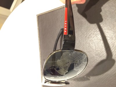

What's Going On with My Polarized Sunglasses?
06/27/2012 6:25 PM
I've searched and searched and I can't find an answer. I'm really surprised that I can't find anything and I really can't think of where else to look, besides the vast amount of knowledge held by our CR4 engineers!
Backstory: I recently got a really nice pair of polarized sunglasses. I think I may have been irresponsible with them by bringing them into contact with salt water at the beach, because something has happened to the lenses that I've never seen before. I have a decent understanding of how polarization works, and I would think this is a layer of the lens that is peeling, got something underneath it (air? salt?) and now it is not crystal clear. It started around the edges, got worse, and has stopped 'spreading'.
The best way I can describe it is from one angle it will look like a layer of the lens is peeling, and at another angle it will look like dust or sand or salt got in there.
I don't know about the nature of the materials used here. So could anyone tell me what might be happening, and if it can be fixed? I brought them to the store they were purchased from and there was nothing they could do. It's getting annoying to look through them, but I'd hate to get rid of them if there is something I can do. If not, at least I'll know. Thanks for the help!

It looks like a layer of metallized film has been laminated to the front of the lenses and that water seeped in around the edges.
Now, metallized film is usually made by depositing aluminum vapor onto the film under vacuum. The amount of deposition determines how transparent the film will be.
When laminating with these films, the metallized layer is always laminated "in". Here's why: If the Al comes in contact with water (and I think that this would be especially true of salt water) it will quickly oxidize - the thinner the coating the quicker the oxidation. The oxidation looks exactly like what is in your photos. I have seen entire rolls of metallized film ruined due to not being packaged well against the weather.
I'm sorry, but if I'm correct, there is no fix for these baby's. I don't know what precautions/directions came with the sunglasses, but, if the glasses were made with a laminated film that came delaminated at the edges that easily (allowing the moisture access to to the Al), I think you got ripped off!

Polarizing film is made by stretching a dye-impregnated plastic. Originally iodine was used as the dye, but there are other dyes used now. This film is very flimsy so to make it useable it is then laminated to another plastic (or glass) that is clear but rigid.
It appears that the adhesive used for bonding the two plastics has failed, allowing the polarizing film to shrink back toward its original dimensions before it was stretched. The adhesive might have failed due to poor preparation of the surfaces, a problem with the adhesive when originally applied, excessive heat or humidity, or maybe the salt water.

Join Date: Oct 2016
Re: What's Going On with My Polarized Sunglasses?
10/14/2016 4:47 PM
Hi
I have similar problem with my Prada polarised sunglasses.
I looks like the outside film is peeling of.
Bought it 2 years ago from The Sunglasshut.
They said warranty expired so they can't help.
Any advise please?
