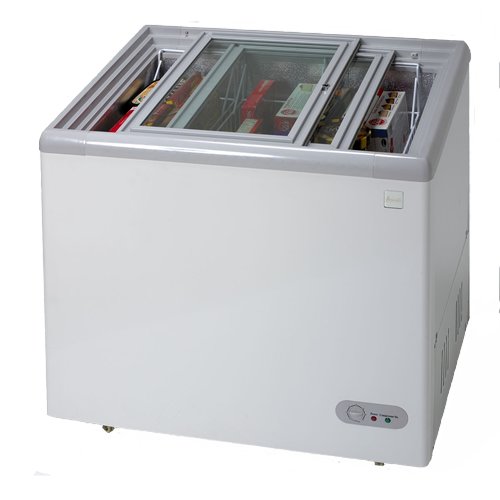

How about aquarium chillers? You would have to come up with a small heat exchanger to cool air. PC chillers come to mind also.
The cheapest way might to buy a used refrigerator and taking it apart for the chilling unit, make a small box to mount compressor and fan. With a little trial and error you should be able to adjust settings to get temp you need.

I like the idea of a used refrigerator, GA. He could even enclose the condenser into a cristal clear plastic box and illuminate it with white LEDs.

  • Peltiers seem doable, but I think I can repurpose a cheap ebay tabletop freezer cheaper and it's likely to be a better construction, knowing my (lack of) engineering skills!
  • Condensation is definitely problematic, which is why I will need a small battery fan to blow air over the lens as I shoot
My hunch would be is that tabletop freezer (ebay £10) with air circulating through use of fans and pumps through to a second posing chamber with twigs and creature will be the way I go in the end, as there's no reason why it shouldn't actually work?
