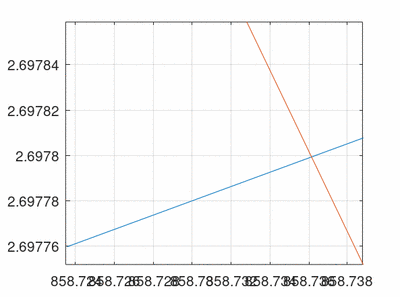

So here's a slightly more difficult problem.
If you do the triple journey from the South pole, the third leg is completely different from the 1st leg. Whereas if you do one of the triple journeys at the North pole the third leg is always exactly the reverse of the first leg.
There is a triple journey (x miles N, x miles W, and x miles S) which starts and ends at the South pole and in which the 3rd leg is the reverse of the 1st leg. Find x?
I cheated and used a spread sheet to get an answer, but, surely there's a way to solve this without a spread sheet or other successive approximation technique.
I'll post my crappy solution after giving others a while to think about it.
Re: Challenge Question: Global Adventurer (March 2022)
03/05/2022 11:27 AM
Well, the distance you walk North is x radians, the circumference of the earth walking along a constant latitude is 2*pi*sin(x) radians. Where the two curves cross is the point where all three legs would be equal.
Plotting y=x and y=2*pi*sin(x):
x=2.6978 radians or about 10791.2 miles
03/05/2022 5:15 PM
A picture might help.
For simplicity, let the earth radius = 1. We can scale it back up later.
Walk north from the south pole a distance x. Your distance from the axis of the earth would be sin(x), and if you turned west and walked around your line of latitude, the distance would be 2*Π*sin(x). We want the value of x such that all three segments are equal, i.e. x = 2*Π*sin(x).
The blue line is the distance walked north (and south). The red curve is the distance walked west at constant latitude as a function of the distance walked north. At the intersection the distances north, west, and south are equal.
Convert from radians to distance by multiplying by the earth's radius.
03/06/2022 6:06 AM
That's what I got:-
We both got 2.6978 radians, so the slight difference will be because of a difference in the value of the radius of the earth.
But we both had to use graphs/successive approximation/inspection.
Surely there's a way to solve
2πsin(θ)/θ = 1 analytically
I'm sure I've seen discussion of the function Sin(θ)/θ before. But all I can find now is proof that it is 1 at θ=0.
