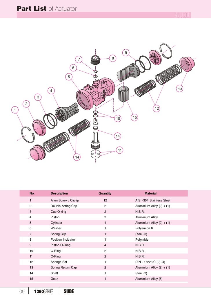

I'm a new Instrument Engineer and now i have problem with Butterfly Control Valve, How to make the disk of Butterfly Control Valve on close position, On air failure is Open, i already did with nitrogen to drive disk but not worked. Thank you.

I'm afraid your post isn't very clear- are you looking to have a pneumatically operated butterfly valve fail (default) to either the open or closed position in the case of air loss??
If so, all you need is a single acting, spring return actuator that is sized appropriately to the valve and material parameters. This can be set up to the required default position.
If you already have a double acting actuator it can still be done, but it is more complex and less reliable than using the appropriate type.

(1) go purchase a double-acting actuator to fit on the stem of your wafer valve to take the place of the present one. Needs spring loading for when air fails to force actuator to return to the position you want it to.
(2) install the new one, and program it to open under air, close under air, whatever, and spring open or closed however you need it to.

The issue is with the actuator, and not the valve. If the necessary skill set is not available locally, telephone the local valves distributor (ideally the one that supplied the equipment in the first instance) and discuss the problem directly. The distributor will have a workshop where the valve can be adapted "air to close, spring open".

If I understand your problem right,you have a fail open butterfly control valve which will not close even if you put nitrogen to actuator.I assume this is a spring return actuator
If you put the correct air or nitrogen pressure in the correct side of the actuator and the valve would not close ,it means
a)The actuator is not sized properly
b)You are not putting the air pressure for which the actuator was sized
OR
c)The valve has an obstruction.If not carefully designed the disc will hit the flange/pipe ID in some design
