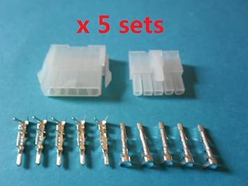

Ok, First a little background.
I'm just finishing putting in a new carpet set on my 86' Porsche 911 Targa Carrera.
When I was connecting up all the wiring harness connectors, I was inspecting them.
I came across this 6-pin connector with one pin broke off. (See Pictures Below) I'm trying to source this part. My normal goto place for parts or forums is;
  • Pelican Parts
  • Automotion
  • Rennlist.com
Nothing so far.
Does any member know what this connector is called, or have experience or a contact, I would like to just replace the pin on the wire if I could.
Female Connector with broken pin still in on the right end.
I may be able to get this out, I tried with a small screw,... but I think if I had even a smaller screw it would work.
This is the Male end with the farthest right pin broke off.
It would be great if I can just replace the pin, but not very experienced with this connector,... or connectors as a whole.
I don't have a wire diagram, I'm not sure if this goes to or if its even used, or how long its been broken. I just assumed that I broke it off, when I disconnected it... but there seems to be some damage around the outside area of the broken pin.

If you just want to replace the pin, maybe a quick-connect kit and just use the pin?
http://secure.chassisshop.com/partdetail/p40008 as an example.
Re: What is this Wiring Harness Connection Called
05/19/2016 1:25 PM
That's what I'm looking for.... thanks
Just have to remove the broken one inside the female.
And thinking out loud.... pulling real hard on the broken male wire until the wire or fitting comes out..

I have to ask... there are wires for all the pins including the "broken" one?
That kind of connector is called a Molex connector, I believe.
https://www.google.com/webhp?sourceid=chrome-instant&ion=1&espv=2&ie=UTF-8#q=molex+connector
05/19/2016 1:15 PM
No, the 6 pin connector has 5 wires for 5 pins, you can see an empty slot at #4.
Molex, great,.... I know I can make headway now.
Thanks for the link.

Crimped or soldered will work... What you need to do if you need the wires soldered is;
Soldered is preferable but Before pulling any wire out...make sure to label and mark each wire! Color coded to each corresponding hole on the molex connector!
All solderings are done outside of the moulded plastic molex body!
first solder each wire to the pin(s), (male or female depending on type).
then insert each already soldered pin(s) to the corresponding hole on the molex plastic!
3) Try to pull /tug each wire out to test if they stay and are locked in place!

If you want to find the right one, the only way I have found (and there may definitely be better ways) is:
  1. Measure the part's dimensions.
  2. Go to DigiKey or Mouser (I like DigiKey better) and start searching through the connector categories until you find similar in size and shape.
  3. At that point you can filter by number of connections.
  4. From that resulting group, start going through their datasheets and find one that matches the dimensions of your part.
It can be very tedious.
Does this plug into a board/equipment or does it connect to another plug with wires?
If the latter, they also make male/female crimp-on connector pairs for individual wires that you could probably find at any auto parts store.

Should be able to find one of these at the local electronics store. The round tube slides down over the pin or socket from the front. It pushes the retainers in.
05/19/2016 7:10 PM
Stopped at radio shack and pick up a kit, also picked up a removal tool. Won't get to it tonight, but I'm confidence of moving on more than this morning.
