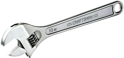

this is an image of an adjustable wrench. over the years it has widely become known as a 'Crescent wrench. the Dupont company calls their line of refrigerants Freon. a brand name is unimportant unless it is spec'd on a bid or blueprints.

Imagine how Gunsmoke's ratings would have soared if, every time he pulled out his gun, Matt Dillon stopped what he was doing, waved his weapon in front of the camera and explained to his TV audience that "This is a Colt .45 single action Army revolver and not, say, a banana."
Likewise there is no ambiguity as to what is meant by 'freon' as the name is commonly understood to mean a "general class of HFCs mainly used in refrigeration." Similarly for for term "crescent wrench" as understood to mean "a type of adjustable wrench."
What is so amazing to me is that somebody actually had to stop and explain this to you. Given some of your other posts, you seem to be more intelligent than that, so I'm guessing you're being deliberately obstinate. For what reason I've no idea. Possibly someone pooped in your coffee this morning and so you're now feeling an urge to lash out?
FFS, grow up.
