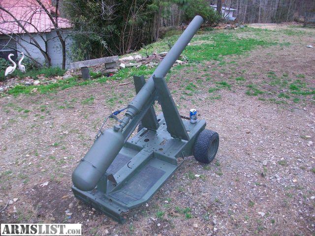

Re: Cross Bow Information
05/18/2017 11:19 PM
Mine was like this one, but bigger.
I used an igniter for a gas BBQ. I also used long threaded 6-32 machines screws in an arrangement where I could adjust the gap for the juiciest spark.
I had removable barrels so I could adjust the length and diameter for different "experiments" ..
Going at it again or in your case I might think about making the main chamber adjustable in size by using a large diameter coupling and pipe nipples of different lengths. .. getting the air/fuel mix and ignition correct may take a couple of tension filled go rounds, but once you've got the gremlins out it's amazingly satisfying to fire.. even with nothing in the barrel. (warning- residual gasses may become flammable some time later and scare the heck out of you and others if you give it a click for no reason while it's laying around.)
If I were you I'd go spend $50 and a couple hours making a proper potato gun to learn a little theory. ANY opportunity to do little R&D feasibility study that involves making a potato cannon should not be passed up. Think about it.
And report back if you do!
..oh.. Also run down to the fabric store for some of these to add weight to your findings..
