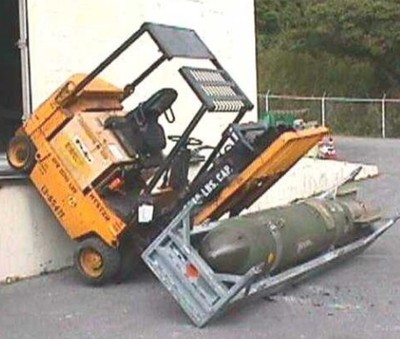

Didn't anyone follow my link to this weeks "caption this". I thought at least Phoenix911 would have recognised the configuration.

Looking at this picture, shouldn't the (extremely lightweight for a forklift) forklift rectangle be rotated 90° with respect to the torpedo/bomb rectangle?
And what of that round thingo? If that represents the contents of the forklift operator's trousers after dropping that load, shouldn't it be in the driver's seat? Or was he wearing Spandex and landed nearby?
