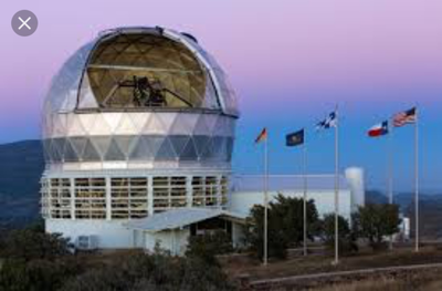

Steal the design from any helicopter that has to send electricity and hydraulics up to the rotor head. A hollow mast with rotating fittings for the liquids and slip rings for the electrical part. Since with a house where you're not dealing with hundreds of rpm's like a helicopter reliability and maintainability should not be much of an issue.
Everything else is just construction that has been done dozens, if not hundreds, of times.

06/23/2017 10:38 AM
You might have to draw me a picture, as I am a bit dense this morning, and I kept imagining the fitting spinning around until the hoses tangle up, sorry. Is it more like a stationary ring and rotating sealed disk arrangement?
Join Date: Mar 2008
Location: Bridgewater, Va.
Posts: 2179
Good Answers: 119
Re: Rotating dwelling with utility hub Challenge of the Month
06/23/2017 11:14 AM
Yes, liquid fitting has a stationary side and a rotating side.
For liquid swivel joints, look HERE. These are not necessarily the right version for a "house" application but I'm too lazy to look further.
For electrical slip rings, look HERE.
I hope this helps. The longer I'm retired the lazier I get. Plus I'm off to check out a travel trailer I might purchase.
