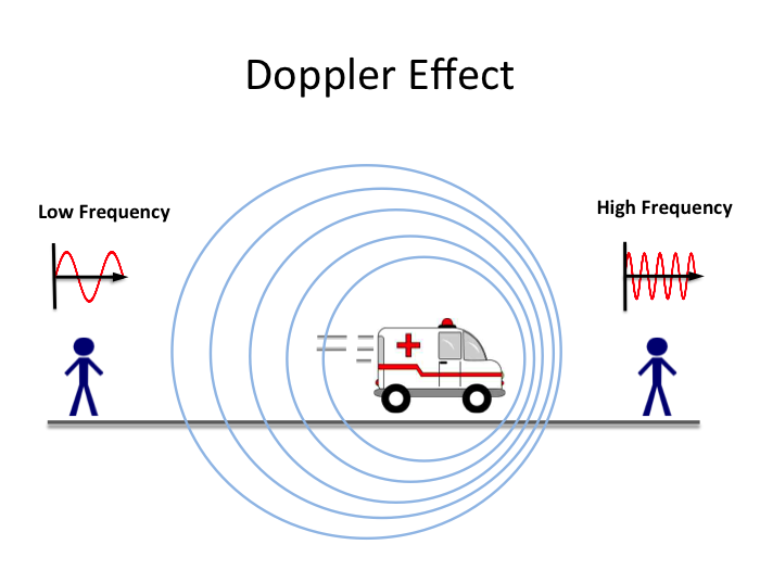

Previous in Forum: MIL SPEC for Cable Labeling   Next in Forum: Is Nuclear Poised For a Comeback?
34 comments
Join Date: Nov 2017
Posts: 2
Speed of Light
11/15/2017 11:23 PM
Assume/Imagine a spaceship travelling at the speed of light. Two lasers are mounted on top of the craft. The 2 lasers are mounted in such a way that,
  1. Pointed forward
  2. Pointed Backward
What will happen to the laser coming out of the torch
Pathfinder Tags: Laser
Re: Speed of Light
11/15/2017 11:29 PM
Nothing.
Your perception of the laser light might change.
Are you inside the spacecraft?
Outside the spacecraft?
Etc?
Re: Speed of Light
11/16/2017 12:47 AM
Location: SPAIN
Posts: 233
Re: Speed of Light
11/16/2017 1:01 AM
You can imagine whatever you want, cause no matter what, it will not happen if your asumption is false.
Building the future!
Re: Speed of Light
11/16/2017 1:04 AM
Take a physics class including red/green-shift calculations. Do not assume 100%c.
Re: Speed of Light
11/16/2017 2:39 AM
"There was a professor named Bright
Who travelled much faster than light
He left one day
In a relative way
And came home the previous night." - Anonymous Poster #0
Posts: 975
Re: Speed of Light
11/16/2017 9:23 AM
Such a brilliant rhyme, my darling. Impressive.
Re: Speed of Light
11/17/2017 3:18 AM
Re: Speed of Light
11/17/2017 8:07 AM
He'd go with everyone!
Re: Speed of Light
11/16/2017 5:07 AM
Both laser beams will travel away from the spaceship at the speed of light.
If you try measure their velocity from any other point, it will still be the speed of light or you won't be able to even see what's a happening...
If a man in a forest says something and there is no woman there to hear him... is he still wrong?
Location: Maine, USA
Posts: 2168
Re: Speed of Light
11/16/2017 9:59 AM
"If a man in a forest says something and there is no woman there to hear him... is he still wrong?
Go ask Mrs. Cat, I'm sure she will have an answer!
Re: Speed of Light
11/16/2017 6:03 AM
Your question is 112 years too late.
einsteins-special-relativity-for-dummies
Re: Speed of Light
11/16/2017 2:28 PM
Or was Einstein 112 years early? Can you tell this in your inertial frame of reference?
Humans.
Lovely inspiring thought, lacking the power to see beyond the kitchen window, yet making biscuits of wonder perfectly suitable for the tea ceremony. How will we ever reach out and touch the stars? We already have. We are the stars (dust).
Re: Speed of Light
11/16/2017 8:05 AM
Speed is relative, you have to specify speed in relative to some reference, for example, the earth. Nothing except light can travel at the speed of light relative to anything else, and light always travels at the "speed of light" relative to everything.
Posts: 975
Re: Speed of Light
11/16/2017 9:22 AM
There is something in the eyes that would probably help explain light.
Questions like
  1. how do you perceive light?
  2. does optical sensory conforms hi-tech light technology?
  3. What type of conversion there exist converting photons to neural transmission?
so on and so forth...
Location: Maine, USA
Posts: 2168
Re: Speed of Light
11/16/2017 9:57 AM
What torch?
Posts: 7954
Re: Speed of Light
11/16/2017 10:30 AM
It's all relative.
Location: Troy, NY
Posts: 122
Re: Speed of Light
11/16/2017 10:47 AM
Depends if the lasers are able to operate in that ambient temperature range. It's pretty cold up in space.
Re: Speed of Light
11/16/2017 2:22 PM
Huge Doppler Effect, one will be reduced to a low frequency virtually nil, since you specify v=c. The other will be very high frequency. I think your laser will blow up in the "head wind" of interstellar gases.
This is in the supposition that something scatters the beams in order for stationary observer in other frame of reference to actually observe the beams.
Otherwise if directly behind the craft, does the beam ever make it out of the event horizon? If directly ahead of the craft, how can the beam propagate fast enough to reach observer before the craft. I suspect a collision of immense energy takes place.
Join Date: Nov 2017
Posts: 2
Re: Speed of Light
11/16/2017 11:29 PM
"Assume/Imagine a spaceship travelling at the speed of light. Two lasers are mounted on top of the craft. The 2 lasers are mounted in such a way that, 1. Pointed forward 2. Pointed Backward What will happen to the laser coming out of the torch"
Thank you all for your valuable comments. The above question I asked is just to understand "what is light".
What if an observer is stationary?
  1. For pointed forward: Will the light velocity be doubled
  2. For pointed backward: Will the light velocity be zero
In addition to this, is it possible / sensible to compare the above scenario with a bullet coming out of a pistol, mounted on a spaceship whose speed is equal to speed of a bullet.
What would be the fate of the light and the bullet for a stationary viewer?
Re: Speed of Light
11/16/2017 11:39 PM
Doppler effect - Wikipedia
Study the Doppler Effect.
Re: Speed of Light
11/17/2017 4:51 AM
<...is it possible / sensible to compare the above scenario with a bullet coming out of a pistol, mounted on a spaceship whose speed is equal to speed of a bullet..> No, it isn't, because bullets don't usually travel anywhere close to the speed of light; speed of sound in air at [temperature/pressure], maybe. Plus, there is by definition no air in space. So the conjecture is absurd.
Join Date: Sep 2007
Posts: 218
Re: Speed of Light
11/17/2017 8:21 AM
Read post 6. Del has it right. The speed of light is constant, no matter your frame of reference. So both lasers will fire at the speed of light.
The problem is who is going to fire the lasers. The person on the spaceship, who according to you is already travelling at c, will have a time reference frame that is stopped, so it will take him to infinity to press the button.
As stated in another previous post, you should talk about approaching the speed of light, not travelling at c.
Re: Speed of Light
11/17/2017 11:10 AM
What is light ? The absence of, which is impossible, because in the absence of light there still is light, although not in our visible spectrum. Like asking what is cold ? Even in extreme cold there is still heat or warmth.
Location: London England.
Posts: 583
Re: Speed of Light
11/17/2017 5:35 AM
I bought my time machine next Thursday, it broke down last Friday, the mechanic said they don't build em like their going to.
Bazzer
Re: Speed of Light
11/17/2017 6:01 AM
Re: Speed of Light
11/17/2017 6:03 AM
em 'em
their they're
Re: Speed of Light
11/17/2017 11:17 AM
They spoke a different language, grammatically tomorrow.
Re: Speed of Light
11/17/2017 11:39 AM
Thus, this thread was over before it began.
Re: Speed of Light
11/17/2017 9:47 AM
Sounds like yur busted before you go anywhere.
Re: Speed of Light
11/17/2017 11:01 AM
Although the spacecraft is moving at the speed of light ( define light spectrum ? ) . What is the speed of the lasers ( define light spectrum ? ) Are the lasers mounted side by side ? What is the length of the craft ?
Join Date: Sep 2007
Posts: 218
Re: Speed of Light
11/17/2017 12:08 PM
The speed of light is the same no matter the spectrum. You are talking frequency.
It's like the speed of sound. The tone does not change the speed of sound.
Re: Speed of Light
11/17/2017 2:04 PM
Same goes for rumors, the tone does not change the speed of the rumor.
Location: Tampa, Florida, USA
Posts: 2129
Re: Speed of Light
11/17/2017 3:04 PM
Ahhh Rumors excellent album.
J B
Re: Speed of Light
11/21/2017 3:12 PM
There will be absolutely no change in the spacecraft or the lasers from pre- to post-firing.
Time dilation increases as speed increases, as speed approaches C, time dilation approaches 0. Traveling at the speed of light, time will stop in the inertial frame of the ship. If t is a fixed, unchanging value then there can be no change of state within that single fixed instant of t.
Now if you change the chips speed from C to 0.99C, then the question can be answered.
From an observer within the ship:
The lasers will spear out from the ship, both traveling at the same speed (C) away from the ship.
From an observer on a planet the ship is passing near, as no maneuvers have been stated the ship will be considered to be traveling at a tangent to the planet, neither flying directly towards nor directly away:
The lasers will spear out from the ship, both traveling at the same speed (C) away from the ship.
This has been a quick lesson in relativity and inertial frames.
Register to Reply 34 comments
adreasler (1); Anonymous Poster (1); Bazzer Englander (1); Brave Sir Robin (1); gutmonarch (2); IdeaSmith (1); Ivanov327950 (1); James Stewart (5); JBTardis (1); lyn (3); Poison (2); PWSlack (4); Rixter (1); rravi12june81 (1); SolarEagle (1); terrapin (1); Tom_Consulting (2); tonyhemet (2); Tornado (1); Usbport (1); user-deleted-1105 (1)
Previous in Forum: MIL SPEC for Cable Labeling   Next in Forum: Is Nuclear Poised For a Comeback?
