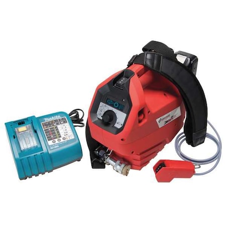

The motor that's in question would be operating a variable displacement hydraulic pump that supplies high pressure fluid to rotating, lifting and linear equipment.
Craig.
Posts: 33401
Re: Industrial Motors
12/15/2017 10:32 AM
How big you wanna' go?
HYDRAULIC PUMP, BATTERY OPERATED
GREENLEE| ZORO #: G7029321| MFR #: EHP700LU11 Reservoir Capacity (Gal.): 0.20 Maximum Pressure: 10,000 psi Application: Utility
Check this...
http://www.allair.com/downloads/files/enerpac/_elec_pumps_e327_us.pdf
