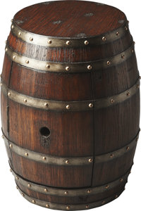

Previous in Forum: TH400 Tranny Spurts Out of Vent   Next in Forum: Soft Skinned Cars
26 comments
Location: Cajun Country , USA
Posts: 1498
Volume and Height of Liquid in a Barrel
09/16/2019 5:55 PM
I have two barrels.
  1. 22" in diameter
  2. 14" in diameter
If I dump 5 US Gallons into each barrel, how high with the liquid go ( in inches) up the side of each barrel?
Re: Volume and Height of liquid in a barrel
09/16/2019 6:27 PM
Assuming the barrels are straight-sided, and the sizes are i.d., ~3.04" and ~7.50" respectively.
Location: Cajun Country , USA
Posts: 1498
Re: Volume and Height of liquid in a barrel
09/16/2019 8:01 PM
So basically, double the height. Thank you.
Re: Volume and Height of liquid in a barrel
09/17/2019 5:35 AM
Height ratio is pi * 11 * 11 / pi * 7 *7 = 121/49 = 2.47
Join Date: May 2008
Posts: 1851
Re: Volume and Height of liquid in a barrel
09/18/2019 12:08 AM
You have considered barrels in vertical position.
If the barrels are in horizontal position what will be the level , and what is the formula.
Thanks,
Dhayanandhan.S
Join Date: May 2018
Posts: 812
Re: Volume and Height of liquid in a barrel
09/18/2019 4:11 AM
To do this calculation with the barrels laying horizontal the length of the barrels need to be known.
Hare today, goon tomorrow!
Join Date: May 2008
Posts: 1851
Re: Volume and Height of liquid in a barrel
09/18/2019 6:23 AM
Quite true.
When the barrel is in horizontal portion, the formula for length will be automatically included. When we talk of formula, represented by L indicates the length, and absolute/actual dimension is not required. I just asked " what is the formula.
Dhayanandhan.S
Re: Volume and Height of liquid in a barrel
09/18/2019 8:51 AM
"If the barrels are in horizontal position what will be the level, [...]"
Re: Volume and Height of liquid in a barrel
09/18/2019 7:30 PM
How do you "dump" water into a barrel lying on its side?
Join Date: Feb 2015
Location: Canada's West Coast , Pacific.
Posts: 34
Re: Volume and Height of liquid in a barrel
10/12/2019 8:07 PM
You Pipe it in.
( FUNNEL)
MAS
Steele113
Re: Volume and Height of liquid in a barrel
09/17/2019 4:40 AM
For a rule of thumb,1.5 inches in the small barrel equals 1 gallon,if you wish to mark it with a center punch or other means.
The larger barrel, approximately every5/8 inch equals one gallon.
Re: Volume and Height of Liquid in a Barrel
09/17/2019 6:51 AM
Ok, now that the height is sorted.. I'd guess the volume to be 5 gallons per barrel?
Location: Surrey BC Canada
Posts: 1571
Good Answers: 42
Re: Volume and Height of Liquid in a Barrel
09/18/2019 12:00 AM
It was a trick question!
Each barrel only holds 10 liters.
Join Date: Jan 2006
Location: Tamworth, UK.
Posts: 1782
Re: Volume and Height of Liquid in a Barrel
09/18/2019 6:01 AM
What shape are the barrels?
If straight then a simple ratio of diameters will give the answer.
Assuming both barrels are large enough to hold all the liquid.
If 'barrel' shaped is the diameter measured at the minor or major axis?
....and come to that, does the curve of a barrel follow a standard formula?
.....and since you have 2 barrels why not pour the liquid in and measure the depth with a dipstick
Location: Cajun Country , USA
Posts: 1498
Re: Volume and Height of Liquid in a Barrel
09/18/2019 9:24 AM
Thank you all for the reply. Ive got the basic answer I needed. NO, it was not a trick question. thank you all again.
Re: Volume and Height of Liquid in a Barrel
09/18/2019 1:31 PM
What about if the barrels are the traditional shaped type...? ...and the diameter given is the max at center id....
https://www.practicalmachinist.com/vb/woodworking-and-woodworking-machinery/woodworking-barrel-stave-pattern-233788/
Location: Surrey BC Canada
Posts: 1571
Good Answers: 42
Re: Volume and Height of Liquid in a Barrel
09/18/2019 2:03 PM
wait for it - it will be rated off topic in a flash.
Re: Volume and Height of Liquid in a Barrel
09/18/2019 4:02 PM
Haha
Location: Surrey BC Canada
Posts: 1571
Good Answers: 42
Re: Volume and Height of Liquid in a Barrel
09/18/2019 6:52 PM
Someone has totally lost a sense of humour.
Re: Volume and Height of Liquid in a Barrel
09/18/2019 10:05 PM
How many monkeys are in a barrel-o-monkeys??
Re: Volume and Height of Liquid in a Barrel
09/18/2019 11:24 PM
42, of course. And gallons of oil, too.
Re: Volume and Height of Liquid in a Barrel
09/19/2019 9:39 AM
No...12...but you can fit 24...
Location: Surrey BC Canada
Posts: 1571
Good Answers: 42
Re: Volume and Height of Liquid in a Barrel
09/19/2019 5:54 PM
OK, I am lost with the barrels of monkeys - let me think on it. Perhaps I don't have the reference point ---sigh.
Re: Volume and Height of Liquid in a Barrel
09/19/2019 7:38 PM
Location: Surrey BC Canada
Posts: 1571
Good Answers: 42
Re: Volume and Height of Liquid in a Barrel
09/19/2019 7:51 PM
I definitely did not have the frame of reference!
Re: Volume and Height of Liquid in a Barrel
09/23/2019 12:12 PM
If it is dumped in too quickly, then it might not stay in the barrel. Try not to stand too close when it happens...
Location: Surrey BC Canada
Posts: 1571
Good Answers: 42
Re: Volume and Height of Liquid in a Barrel
09/23/2019 12:21 PM
This thread has no humour - wait for it - --- should be OT in seconds. (and not by me )
Register to Reply 26 comments
Anonymous Poster (1); dhayanandhan (2); Dragon113 (1); GW (6); HiTekRedNek (1); horace40 (1); JE in Chicago (1); JohnDG (1); lyn (1); netmaker (2); PWSlack (1); SolarEagle (5); Stef (1); Tornado (2)
Previous in Forum: TH400 Tranny Spurts Out of Vent   Next in Forum: Soft Skinned Cars
