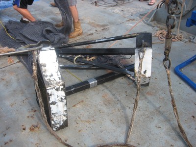

THIS is what happened a few years back on a similar research expedition.
This expedition used a Misago Sled Beam. On its third deployment, it hit "something" and the 6"x 6"x 3/4" steel beam was torn in two. Both sections and the net came up still attached to the 16mm Dyneema Towline.
This is the reason for trying to use more economical gear to spread the trawl net as the loss ratio can be severe.

They told me they only felt a "slight bump" and then the Load Cell meter dropped 45%, letting them know the gear had lost its integrity.
Re: Deep Water Question
04/13/2020 12:44 AM
That looks like a failed weld. Metals should not fail in the weld and definitely should not look llike that if a failure does happen in a weld zone. Notice the base material does not look at all deformed.
...or is that something other than a weld?
If that is a weld, then the structure would have been far more robust with a decent weld.

04/11/2020 7:09 AM
CORRECT! See Pictures............

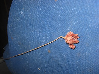

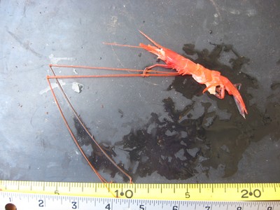

FYI
some of the weird stuff from 2.75 miles down in the Pacific.
