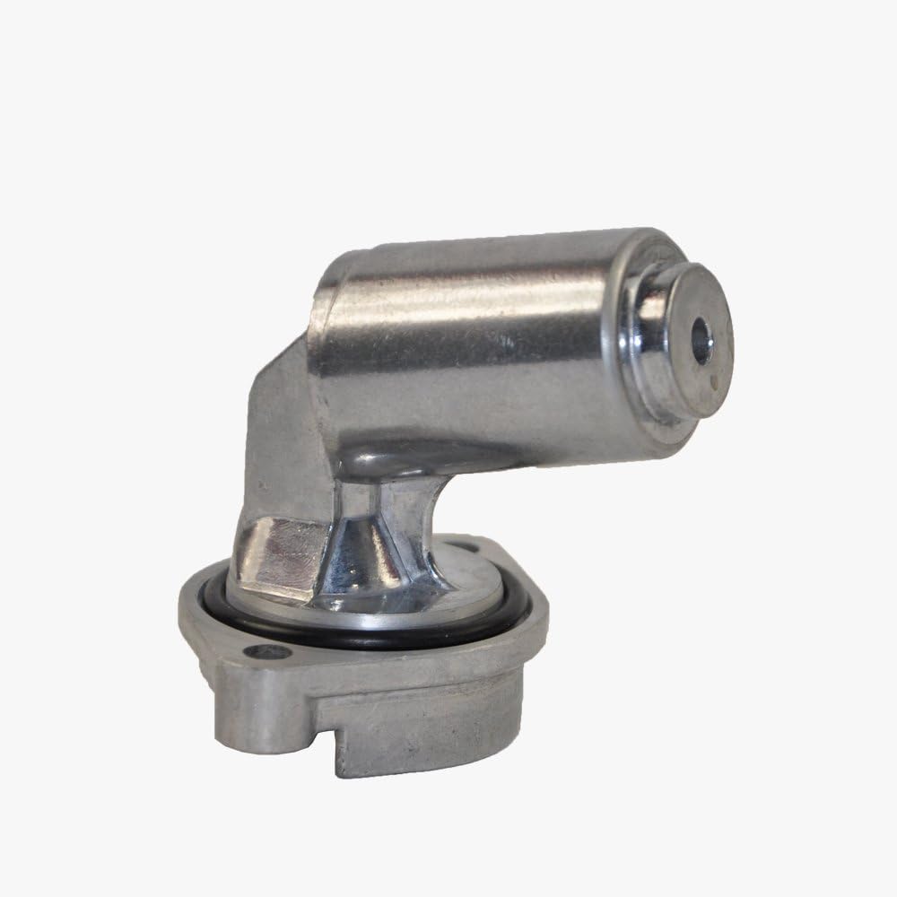

Hi I would like to install a low oil level sensor on my 1985 Mercedes diesel engine. It would need to go into the oil pan at a horizontal position and normally be covered by the engine oil. It would have to withstand oil at about 180 degrees Fahrenheit and about 5 pound of blow-by pressure. It could go in about 3 inches max and be about 1 inches in diameter. If the oil pan has to be beefed up in that area so be it. The low level sensor will provide a short to sound an alarm. Any sensor people out there with any ideas??? Thanks

Posts: 9941
Re: Engine Low Oil Level Sensor
07/29/2020 11:14 AM
https://www.amazon.com/Mercedes-Engine-Sensor-OEM-Quality-1240017/dp/B00D8M23G6
As JE noted, it's only accurate before the engine is started.

07/29/2020 9:59 PM
I looked at one of these at my mechanics shop and we thought it was too large. That is why I wanted to see if the industry had a smaller sensor.

At least Ford & Audi furnish oil level sensors for some of their vehicles. Some look like they are integrated with a drain plug, no reason not to install horizontally higher in the oil pan if too low above the bottom. Here is an Audi unit, looks like it goes in from the side. Better proven technology in the application rather than experimenting with industrial technology in one-off application. Also cost will be commensurate with market penetration.
Join Date: Apr 2020
Posts: 22
07/30/2020 9:04 PM
It looks like for $16.00 it may be worth a shot even if I have to modify it or the oil pan.
