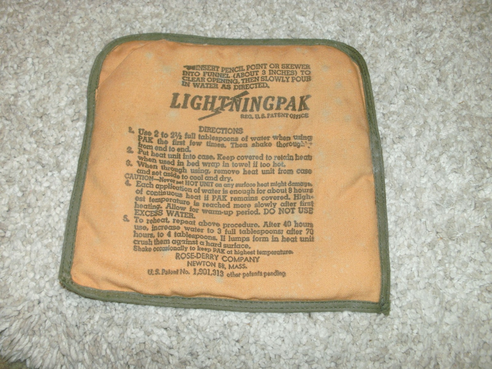

I remember,back in the '50's a heat pad used by the military for medical purposes.It weighed about 4 pounds,felt like sand, and was in a canvas bag with a pouch on the side.
A tablespoon or so of water was put into the pouch,and it was slowly absorbed into the inside.
After the water was absorbed through the semi permeable pouch,one must massage the bag for a couple of minutes to disperse the water.
It would eventually,after about 5 minutes, get up to a comfortably hot temperature, and would dry out after several hours.
It could be reused hundreds of times.I do not know the chemicals inside,but I suspect probably iron and/or aluminum powder and sand as a buffer and thermal sink.
If too much water was added,it would become too hot to hold.
I have searched surplus sites in vain for this heat pad,but have not been able to find one.
It would certainly be a comfort for old bones.I know there are commercially available heat pads,but this was very simple and ruggedly durable;Drop it,throw it,step on it,run over it,it didn't matter. It could take a kickin' and keep on tickin'.
Simply add water.No boiling required.
I know lots of these were used in sleeping bags in Arctic conditions,and saved many toes.
(In days of old, people would put hot bricks wrapped in flannel at the foot of the bed to keep their feet warm.)
If anyone has a link to this old heat pack,I would appreciate it.
Thanks in advance for any assistance on this!

They must have been designed for longevity,with the amount of water required for each step precisely calculated.
More water created more heat,but it would dry out quicker,and grow cold when it was dry.Sort of self-limiting after a certain temperature,due to increased evaporation,it would not ignite itself.
Must have been designed by a chemical/metallurgical genius.
They did seem to require more water as they got older,after about 50 uses,but even when half-dead they would still get warm enough to be worth carrying on a long march in arctic weather.
They would be too heavy for a civilian hiker to carry,so there probably is not a large commercial market for them.They would opt for the modern version.As long as you have the ability to recharge them,no problem.
Now the military has self heating meals,which are simply lye..add water=heat.
The self cooling cans are sodium nitrate--add water=very cold.
Whatever the chemicals,and ratios, they were a fantastic invention.
Certainly would like to know the ingredients of the old canvass ones.
Any old medics remember those?

BUT:this was a multi use heat pad.Did not need to be heated.It simply required the addition of water.
It could have been as simple as lye,mixed with sand,and when it dried out,the reaction stopped.The canvas pouch was semi-permeable to water,and it would take about 5 minutes to absorb the water.The the bag had to be massaged for a couple of minutes to distribute the moisture.Then it would stay hot till it dried out;several hours.It felt like a bag of sand,weight and texture.
Cannot find it on any surplus sites.There may be some in the fallout shelters from the 50's and 60's somewhere.
IMHO:You are the Guru of net searches,so if you can't find it, probably no one can.

...."This is a US Army Medical Department LIGHTNINGPAK Heat Pad. One version is shown in the March 1944 MEDICAL SUPPLY CATALOG on plate 39. It has an OD Case marked with a caduceus and US. It measures 7 1/2" by 7 1/2". The top lifts up so you can insert the Heat Pack. The Heat Pack is is a khaki color and marked LIGHTNINGPAK and has directions all over it. On the bottom it is marked ROSE-DERRY COMPANY, Newton Mass. It has a patent number of 1,901913. These heat pads were issued to doctors and NCO corpsmen in the Aid Stations or Hospitals. "...
https://armysurpluswarehouse.com/heat-pad/
https://www.us-army-military-shop.de/Ausruestung/sonstiges/US-ARMY-HeizbeutelWaermebeutel::263.html

05/11/2021 4:19 AM
BINGO! You found it!
I searched diligently but in vain for it.
Thanks a million!
Any way to find out the ingredients?
The second link is the one I am referring to.
The first link is a hand warmer,with very limited cycle life.
Now I will try to find a supplier in the USA for it.
