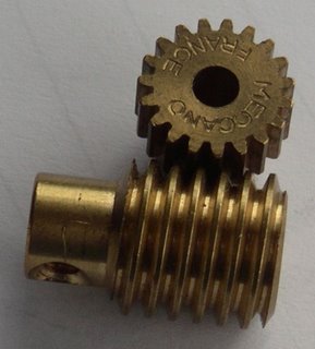

my suggestion is to not use a pinion but a worm gear (or pair of worm gears w chain), and that way the ratchet is not required. also I believe that less power will be required in the motor.

my worm gear idea would be applied to the sliding leg of the scissor (see post #7 excellent diagram) where you would otherwise place your pinion gear.
or you can use the worm to drive the pinion gear

Re: Lifting Structure Help
12/11/2010 2:42 PM
sorry this took so long.. this is what I was thinking of. hope it makes sense.

Hi Chris,
Good example of "works in modeling" but has real world issues.
Have a closer look at worm thread forms and you will see the 'wheel' is like helical, or more correctly a "spiral" form. This is incompatible with a 'rack', outside Meccano fudging, which is quite inefficient.
What you'd need to do is either make a very tricky rack, like half a worm form, or put a conventional gear along side the worm wheel, to do the rack part.
34.5
(I'm on 'you've done it too much') (intentionally this time, for data gathering purposes)
Posts: 5916
Good Answers: 204
12/11/2010 9:38 PM
I think you are right.

12/11/2010 9:17 PM
Cute mechanism. However, note that the rack teeth will need to be crowned and angled to match the worm wheel.
Posts: 5916
Good Answers: 204
12/11/2010 9:39 PM
I'm hearing that.
I'll see about angling the teeth, or twinning the worm driven gear with a straight toothed gear..
