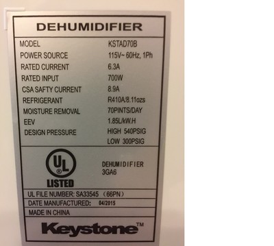

Re: Electric Bill Enigma: Newsletter Challenge (February 2018)
02/02/2018 9:42 AM
When I investigated my apparent large power consumption spike using the appliance, I found the specs are misleading.
IIRC, the rating of 255 watts in your example is actually per liter of water produced, removed from the air. This rather deceptive technique is, best I can figure, how all of these wattsuckers are rated. A consumer believes the equivalent is 4 ea 60 watt incandescent bulbs, more or less, but it is quite a bit higher.
If someone can confirm this, please do so. My memory is sort of fuzzy, and I haven't used the device in several years. I still have it, and I'm hoping I never need it again.
02/02/2018 1:05 PM
The Watt is a unit of power, not energy, so can't correspond to any specific quantity of water removed. It could correspond to a rate of water removal, such as liters or pints per day.
This (very questionable) 2018 table, seen today on a dehumidifier review site (www.bestdehumidifiersguide.com) indicates much lower power ratings:
81.2 Watts (the highest power unit tested) corresponds to only 2kWh per day, or 60 kWh per month, not "hundreds of dollars" for a month.
BUT, the first spec sheet I found was for an LG LD451EGL, which is rated at 45 pints per day, and it specifies 590 watts. Since the larger home units remove 70 pints per day, this could be considered a "small" dehumidifier. 590 W 24/7 corresponds to 425 kWh per month.
Even at a high rate of $0.25/kWh, that would be $106/month; still not what I'd call "hundreds of dollars".
The "Energy Star 2.0" ratings indicate a minimum of 1.5 liters/kWh of energy for medium sized dehumidifiers. 45 pints per day would be ≈21 liters per day, and would thus require ≈14kWh per day, or 422 kWh per month, which corresponds quite well to the LG data.
The large discrepancy between the above table, from a supposedly independent testing agency, and the actual rated power of the one spec sheet seen and the agreement of that with the Energy Star data, seem to indicate some unscientific use of data...
I saw no clues to other possible energy drains in the original challenge; I'll be interested to see the answer...
Hopefully, I'll go check out one or more actual units today...
02/07/2018 5:30 PM
Interesting that your unit uses only 6.3 Amps.
I just checked in the local big box store. They have 30, 50, and 70 pint GE™ dehumidifiers, all rated at 115V 15A. This is the only numeric indication of energy use on the outside of the box, and there were no open boxes to check the device labels. I do believe I remember seeing the Energy Star emblem, but it was not on the same box face with the power label (this happens to be from the 30 pint box, but they were all the same):
Since they all use 15 Amps, I presume they all use the same mechanism. Presumably the larger units have larger radiators and of course larger storage chambers.
