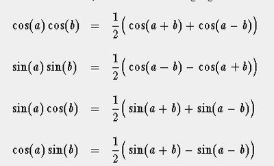

Little known secret. Modulator forms a product of the waves, and so does FM modulator. Do the math. It produces side frequencies.
Join Date: Mar 2005
Posts: 214
Re: Fuddled Frequencies: Newsletter Challenge (January 2018)
01/02/2018 4:27 PM
You are right! But, you did not answer the main question.

..and what a fine table it is, sir.
No sharp corners to poke us.
