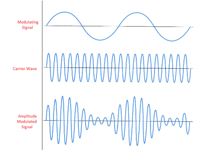

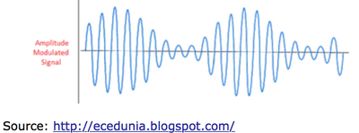

Suppose your preferred AM radio station is located at 800 kHz on your radio dial, and you have a very special, perfect radio receiver that can only tune exactly at 800 kHz, excluding all other frequencies. Would you hear the music more clearly using such a radio receiver, or there is no difference between it and a standard receiver? Can this be true if you have an FM receiver with the same characteristics?
And the answer is:
If the radio receiver is limited to exactly one frequency it cannot receive modulated waves, and without modulation no information can be transmitted – only hum. This is true for FM radios as well.
In order for a radio transmission to carry information (music in this case), the main signal (music) has to be modulated so it can make “different expressions.” AM waves are modulated by “adding” a high frequency (the carrier; this is the frequency at which you should tune your receiver) to the original signal (modulating signal). The result is a signal with highs and lows is shown in the figure.
The amplitude-modulated signal contains more than one frequency and the radio receiver must be able to receive all frequencies, including the frequency of the original signal.

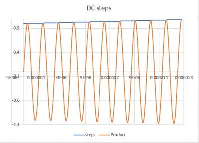

What you are describing is simply an extension of what I said in post #122, and Rixter answered in #123.
Thinking about the properties of high Q resonant circuits allowed me to understand the limitations of such circuits to respond to rapid changes in amplitude, and thus reconcile my thoughts with those of the people who rely on the mathematics of adding and multiplying sine waves to reach their conclusions.
BUT! The original post did indeed say "...perfect radio receiver that can only tune exactly at 800 kHz". If it is a "perfect" receiver, then it should not have the limitations of resonant circuits, and should be able to receive and resolve any 800kHz signal having an amplitude between some lower and upper limits.
Such a receiver could, for example, measure the average voltage of each positive half-cycle (an envelope detector), or invert the negative halves and measure every half-cycle for maximum response (an improved envelope detector). If, as you indicated, the transmitter made all amplitude changes exactly at the zero crossover points, then there would be no frequencies other than 800kHz in the transmitted signal, and there would be no sidebands.
The OP said nothing about the transmitter, but if we can have a perfect receiver, then we should also be able to have a perfect transmitter, capable of doing the above. If, as amichelen says in post #134, "This is a theoretical question and a non-existing receiver." then we may as well have a theoretical, non-existing transmitter as well.
The only problem I see with this is the manner in which the receiver would reject other frequencies, but since it is a perfect receiver, that's not my problem.
I see no reason why such an AM transmitter could not be built, and then with that perfect receiver, it should easily be able to detect all the audio frequencies encoded into that 800kHz signal.

"The reason is that the frequency spectrum doesn't represent a single cycle of the carrier, it represents the signal for its entire duration."
That is exactly my point.
That is why trying to answer this question using the frequency domain is completely pointless.
You have to look at in (the incredibly easy to understand) time domain.

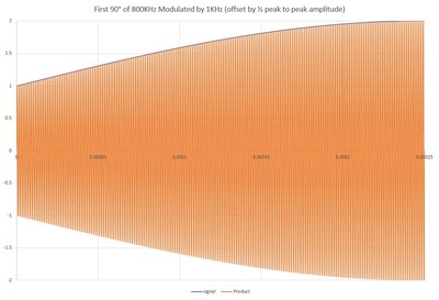

Re: Fuddled Frequencies: Newsletter Challenge (January 2018)
01/10/2018 7:41 AM
I'm not trying to be opaque: I'm trying to be really transparent. You said " a pure sine wave", and I said "at what amplitude?"
This is the first 90° of the 800KHz carrier being modulated by a 1KHz signal offset by half the peak to peak amplitude.
If you looked at the signals with a scope, and, captured 10 cycles of the carrier on the input to the filter around the 30° point; this is what you'd see.
What do you think you'd see on the output of the filter?

Randall, You can assume an amplitude that makes the received signal to be able to be heard by the listener. In reality, the amplitude is not of utmost importance. Choose any value, and the answer will be the same.
I do not understand what you want to convey with the figures you include in your post.
