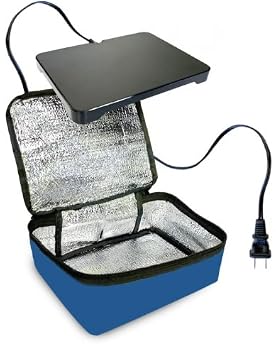

Does any one have the circuit for a diy warmer to keep food/water/air at a constant temperature between 40-45 deg Celsius?
I am open to modifying a 40 watt incandescent bulb to maximise heat emission.
Thank you in advance for sharing.

The electric circuit is the easy part. The hard part is understanding thermodynamics so you can attempt to make this oven or toaster.

A thermostat comes to mind but...How much air/water/food do you intend to "slow cook" with this device?

What's the problem? The circuit is too simple to bother detailing, as other posters have said. Just get hold of a thermostat and put it in the box or whatever along with the 40-watt bulb and the food. At a pinch you could use a heating system strap-on pipe thermostat, making sure the adjustment covers your range.
Of course heat losses must be less than 40 watt or it won't maintain the temperature.

I doubt this can be done at all with a 40W heater. The Easy Bake ovens that used an incandescent bulb for a heat source used a 100W bulb.

True, but a light bulb heated Easy Bake oven could barely make just one high surface area cupcake at a time. As I said earlier the difficult part will be determining if 40W of heat is enough for this unspecified amount of food/water/air in an equally unspecified location.

If you have a good insulating enclosure such as a styrofoam cooler, 40 W should be enough. Obviously, the outside temperature needs to be lower than the desired inside temperature. A thermostat can be used, but it is an on-off device with a dead zone. If you need closer control of the temperature, the circuit below could be used (it will work on 120 volts AC).
http://www.electroschematics.com/5990/smart-heater-controller-circuit/

I would leave the bulb clear. Spread the 40 W around, not concentrate it in one place. Keeping the heat in the bulb will shorten its lifetime.

Google on "do it yourself food dehydrator", you'll find complete instructions for building the box and how to wire two bulbs in series as a heating source. NB- maximizing heat emission is not your goal, minimizing the radiant energy is, since you're trying to warm the food not cook it.
