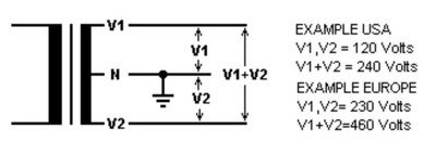

The 220 at the panel has a neutral. The wire to the thermostat has two hot lines. The old heater did not have a ground nor a neutral either.

Old-style, two-prong, unpolarised outlets and the things that plugged into them back then didn't either - and because of internal shorts twice nearly electrocuted me as result.
Not bonding/grounding the user-facing metal parts of anything plugged/wired into the mains is never a good idea regardless of its prior history and/or lineage. It was dangerous then and it is dangerous now. It is only by the grace of God that I'm even able to write you this. Please do yourself and everyone you care for a huge favor and ground it.

Due to the fact that many circuits in US houses use an incoming single 220VAC phase, (often wrongly called 2 phase, even by so called professionals!!!), which is grounded to supply a neutral for 110VAC loads, there is on the unswitched side of the heater 110VAC, now passing through say half of the heater element (heating it up), exiting at the pinhole and via the water, through the mountings, into the fabric of the house, brickwork etc., which is a very poor but effective enough ground.
Effective enough to cause a shock! Maybe even to kill someone....
A proper RCD would catch that, even without a "proper" ground, but more to the point, the insurance company will not honour any damages, if not installed to PROPER code.....
That its often done is not a let out......remember, any neutral/ground center taps on that 220VAC single phase, even in a neighbor's house, canl still cause the problem!!
In countries where 50Hz 240VAC are the domestic supply, as long as the single live feed (the other is the neutral/ground) is switched by the thermostat, this cannot happen.

Also, as far as I am aware, there MUST be a link to both the transformer Neutral and ground lines, to your Condo...how else would you get 110VDC?
Adding a link inhouse, to neutral, and calling it ground, is what was used in Germany many years ago. I don't like it and I don't know what you code, any of them, would say about that!! But it would be a tick safer if properly done....
But I have to admit (been informed here by other CR4ers), really old code in the USA was totally dangerous, and it varied from place to place!!
