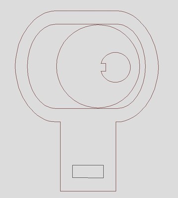

Hi folks, I am using a hand driven pump like the yellow one on the picture . I want to use an engine for that pump instead of using my hands and a pump arm.
I will disassamble the long arm from my yellow pump and will want to transmit engine power to the piston.
Engine power is 0.6 kW
rotation of my engine is 50 per minute.
Shaft on the engine will need to be able to rotate under load approx 400 kG ( that is what the maximum weight needed to be put on the piston)
will the engine 0.4 kW ( 50 rpm) be strong enough for that job ?
Can you please advice which way is best for transmission of the engine power to the piston ? I have few example below, but maybe there is a better way ?
THank you for help !

Your easiest approach to get your motor to work will be a large cam on the motor. Are sure dead sure you want 50/minute? By gearing down a higher speed motor, you obviously already should know you have a force (torque) multiplier in hand.

Rotation speed w = 50 rpm = 5/6 rps = 2*pi*(5/6) = 5.23 radians per second
Power = 0.4 kW = 295 ft lb/sec
Torque = Power/w = 295/5.23 = 56.3 ft lb
Force = 400 KG = 880 lb
Radius = Torque/Force = 0.07 ft = .84 inches
So, if your pump stroke is less 2 x Radius, you should have enough power. (From the looks of the picture, it looks OK)

I suppose the "easiest" way would be an output disc on the motor shaft, with a Pittman arm attached, and the Pittman would operate the pump plunger back and forth (or up and down, depending on the lie of the land).

Can you give us a sketch of what the rod end of the piston looks like?
My hydraulic press has a similar looking pump.
If it is the same you need to push and pull the rod end, it is not spring return.
I assume you will remove the handle and drive the piston rod directly.
Lets say you use a connecting rod from the end of the piston - then we need to know the required throw for a complete stroke.
If the other end of the connecting rod is connected to a crank on the (gear) motor, then the throw would be the 2 x the radius of the crank. Reducing the throw of the crank will reduce the torque required, but will also reduce the volume of each stroke.
Basic power calculations
T = HP x 5252/ rpm
400w = 400/756 = .529HP
T = .529 x 5252 / 50 = 55 ftlbs
400kg = 880 lbs
when the crank is at 90 deg to the cylinder it needs to develop 880lbs
Max possible radius of crank to develope 880lbs is then 55/880 x 12in/ft = .75 inches
That would give a 1.5 inch throw.
My pump has a 1 inch throw - therefore set your crank radius to less than .5 inches.
Use a long crank arm or you will severely side load the piston. Suggest at least 6 inches.
Consider using a high pressure hydraulic relief valve, or you could easily damage parts.
Alternatively install a high pressure hydraulic switch that will turn your pump off.
I would use both.
Be sure to use heavy bearings on your crank - it will be "pushing" over 880 lbs - design should be for at least 3000 lbs thrust.
The crank pins should also be sized for about 3000 lbs. Without detailed calculations I would expect the crank pin to be 3/8 grade 8 bolt or larger..
I do not have the background to estimate the rod size so it does not buckle - but would guess around .75 inches diameter.
A motorized pump is going to be very fast compared to hand pumping. There will be no "feel" to a motorized system. Use a momentary push button for the motor run. Be sure to use pressure gauges.
