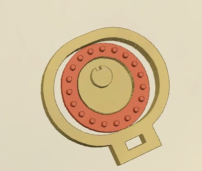

Hi folks, I am using a hand driven pump like the yellow one on the picture . I want to use an engine for that pump instead of using my hands and a pump arm.
I will disassamble the long arm from my yellow pump and will want to transmit engine power to the piston.
Engine power is 0.6 kW
rotation of my engine is 50 per minute.
Shaft on the engine will need to be able to rotate under load approx 400 kG ( that is what the maximum weight needed to be put on the piston)
will the engine 0.4 kW ( 50 rpm) be strong enough for that job ?
Can you please advice which way is best for transmission of the engine power to the piston ? I have few example below, but maybe there is a better way ?
THank you for help !
Frank

Try just the cam to start with.
The fancy follower you have drawn has to be machined to close tolerances to work smoothly. It also needs a guide to slide in - more precision machining. A connecting rod with commercially available bearings will be much easier to make.
The cam and follower should be hardened steel. Try using drill rod (W1 tool steel), machine your cam, then harden. You may need to grind after hardening to get a smooth finish. It should wear well. (W1 when hardened cannot be cut with a file!)

so I will make it with bearing.

With a yoke you will need guides - I would suggest both top and bottom.
If you can find the bearing, you could use a spring return on the piston and use the bearing like a roller cam.

This one I made with bearing and it works like wonder. Its quite, and gentle.
500 bars easly and fast available. This is what I meant to !
Thank you folks for hepling !

here is a sketch.
link to the movie :
https://photos.app.goo.gl/mj7UIn9aZVQBKOrf2
I would still change two things : make a frame for motor to be more stiffer ( it bends a bit now when pumping on high power)
and make that steel element ( in which bearing moves) smaller size, very precise so bearing would be more tight in that. That would make it even more silent, I guess.

You may be able to change the yoke to a connecting rod. Tolerances would be easier to hold because it is just a round hole. The yoke is going to "want" to change shape.

so you mean the basic one ...yes it would be better....but the frame I already made ...there isnt much space to make a rod long....so the side loading on the piston would be a problem

.25 inch off set with a 2.8 inch "rod" is only +/- 5deg.
May be long enough ---- considering the large side load the high lift cam was delivering without damage(?).

I may try it ;) so it should be almost perfect...and its funny but its the simplest one...and few people suggested me that...and even I had a picture of crank, in my first post ...I dont know why I didnt use it and insted I went for following cam...it took me ages to find out that bearing is a must in that mechanism.
600 bars oil preassure in one minute. That is very good. I have asked at few shops specialized in hydraulic pomps, and only one of them had an offer for a oil pomp that needs air preassure compressor...1200 dollars. My motor was 100 dollars, and steel pieces and cutting 150 dollars.
