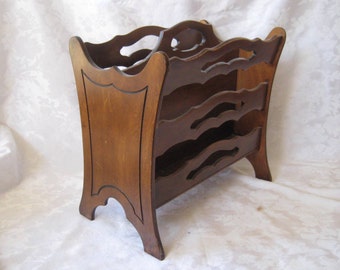

Previous in Forum: What is it?   Next in Forum: What Caused This Label Migration?
64 comments
Posts: 901
Anyone Know What This May Have Been?
10/07/2014 5:35 PM
This table, anyone have any idea as to what it was used for?
Re: Anyone Know What This May Have Been?
10/07/2014 5:47 PM
A writing desk? For a corner of a room?
Maybe a student's desk?
Don't have a clue.
Location: Maine, USA
Posts: 2168
Re: Anyone Know What This May Have Been?
10/07/2014 6:45 PM
It looks to me like a one-off home made work bench. The feet are such that it is pretty stable, and the "work surface" is pretty thick for a writing desk. It has the work surface extended over the base such that you would have room for clamps to hold work. That little tray under would be in the way if you wanted to sit and write.
IMHO
Re: Anyone Know What This May Have Been?
10/09/2014 2:14 AM
I'm with you.
My guess would have been for a watchmaker/repairer or other "fine" mechanical stuff. But really I have no idea.....
Re: Anyone Know What This May Have Been?
10/07/2014 6:52 PM
Some type of sewing machine table
Location: Maryland
Posts: 567
Good Answers: 29
Re: Anyone Know What This May Have Been?
10/07/2014 7:14 PM
Are there clamp marks along the edges? Any signs of equipment or materials being placed on it or fastened to it? Any signs of anything in the drawer, pencil dust, ink? What kind of wood is it?
Looks pretty beefy, like it was built to hold something heavy. Tho' that could be just that it was custom built.
Posts: 1058
Good Answers: 88
Re: Anyone Know What This May Have Been?
10/07/2014 7:20 PM
To support this device? S.M.
Re: Anyone Know What This May Have Been?
10/14/2014 3:57 PM
NO....
Re: Anyone Know What This May Have Been?
10/07/2014 8:41 PM
Looks like a custom made phone desk.....
Location: Tampa, Florida, USA
Posts: 2129
Re: Anyone Know What This May Have Been?
10/08/2014 2:11 PM
Looks like a custom made phone desk.....
Uhhmmmm not to me it doesn't.
J B
Location: Silicon Valley
Posts: 5356
Good Answers: 50
Re: Anyone Know What This May Have Been?
10/07/2014 10:13 PM
It's a wickersham table. The ledge and holes are for the wickerham's decklers.
Posts: 2
Re: Anyone Know What This May Have Been?
10/08/2014 2:36 AM
Just for me.... what is a Wickersham table?
Never heard of it. Can't find it in Google neither.
Location: Maine, USA
Posts: 2168
Re: Anyone Know What This May Have Been?
10/08/2014 7:31 AM
Wickersham table sometimes called a Henweigh.
Join Date: Nov 2012
Posts: 633
Re: Anyone Know What This May Have Been?
10/09/2014 6:45 AM
Just have to ask..."What's a Henweigh? I have to size the Potfor.
Posts: 7458
Re: Anyone Know What This May Have Been?
10/09/2014 2:22 PM
Just have to ask..."What's a Henweigh? About three and a half pounds.
I have to size the Potfor. Gee, what's a Potfor?
I have my reputation as a good straightman to uphold
I think both of these were covered in Chapter 75, subsection title Aduckdo, of The CR Guide to Shameless Self-Promotion, available from the good folks at LynDoor Press.
Join Date: Nov 2012
Posts: 633
Re: Anyone Know What This May Have Been?
10/09/2014 2:28 PM
Well, it was to cook the rabbit..., but it should suffice for a medium size chicken.
Posts: 267
Good Answers: 22
Re: Anyone Know What This May Have Been?
10/08/2014 11:29 PM
I've never seen a wickerham's deckler that would fit in those holes (the progues might hook in - sure, but if two or more were rested at once then the lug handles would foul). My money's on it being a sheeting desk for eustomb binding. It doesn't look old enough I know - but believe it or not there were eustomb guilds in areas of Europe up to the mid 18th C.
Location: London NE, UK
Posts: 154
Re: Anyone Know What This May Have Been?
10/09/2014 8:10 AM
The drawer is generally used for reference documents - for example, the rules and guidelines for Mornington Crescent.
Re: Anyone Know What This May Have Been?
10/08/2014 6:47 AM
Looks like an old home-made writing desk. The upper shelf may have held bottles of ink and the holes might have held fountain pens. The drawer might have held paper and the knee shelf looks like it is angled to hold books like a dictionary and thesaurus.
Posts: 901
Re: Anyone Know What This May Have Been?
10/08/2014 8:58 AM
So far the majority thinks something of a writing table. Except for as someone mentioned the beefyness.
The shelf with the many holes, led one person to thing a writing table again but more specialized like a califagry (sp?) where the holes held different size pens, and or colors of inks.
Any rough guess to age?
Location: Maine, USA
Posts: 2168
Re: Anyone Know What This May Have Been?
10/08/2014 9:29 AM
Any chance you could supply more pictures? Underside, back, sides, closeup of top etc., how it's all joined?
What types of fasteners and joinery are used will help with the age.
Location: Kansas
Posts: 159
Re: Anyone Know What This May Have Been?
10/09/2014 1:20 AM
Do you mean calligraphy, perhaps?
Re: Anyone Know What This May Have Been?
10/14/2014 4:01 PM
Due to the beefiness of the table, I suggest it is Moses' table for writing on stone tablets, and the holes in the upper shelf are obviously for the chisels.
Maybe it has something to do with spinning, and the holes are for bobbins of freshly spun thread?
Re: Anyone Know What This May Have Been?
10/08/2014 11:23 AM
The asymmetry of the design implies the left side of this table is the work area while the five holes on the small shelf will hold frequently used unknown tools. Since there is no room for knees under this table, I doubt that it is a desk. Unless there are some tooling marks that imply a purpose I suspect the intent of this design is lost forever to history.
This doesn't stop anyone for making a WAG.
My WAG is that this is a shop class project that resulted in this small table. I would use this table near a door to temporarily hold packages as one removes or dons a coat.
Posts: 3385
Good Answers: 97
Re: Anyone Know What This May Have Been?
10/08/2014 11:31 AM
Some sort of desk for knitting, croch-iting or needlepoint with the holes to payout the yarn?
(Not that I would knit anything)
CRTL-Z
Re: Anyone Know What This May Have Been?
10/08/2014 12:37 PM
Interesting idea. Maybe the holes should have a belaying pin inserted for securing a line. I wonder if Netmaker might have some insight?
Posts: 3385
Good Answers: 97
Re: Anyone Know What This May Have Been?
10/08/2014 12:45 PM
The only things I am certain of is:
  • It had to have been a tree at one time.
  • Those Two Brothers on Antiques Roadshow would value it between $5000.00 and $7000.00.
CRTL-Z
Re: Anyone Know What This May Have Been?
10/08/2014 1:12 PM
This might be an interesting spin-off program to Antiques Roadshow. Have some certified "antiques" from the show go through a much more scientific, forensic analysis of the age some of the objects. Since the scientific techniques reveal information that cannot be easily or afford-ably faked, the program could focus on the scientific methods in detail. I'd expect that most of the time the expert opinion would agree with the forensic analysis but once in awhile an expert would be found to be wrong in their judgement.
The final rub in the program would be a comparison of the cost in man hours and equipment expenses for the expert's opinion versus the scientific analysis.
Join Date: Oct 2007
Location: Sour Lake, TX 30°08'59.68"N 94°19'42.81"W
Posts: 675
Re: Anyone Know What This May Have Been?
10/08/2014 1:12 PM
It is a desk! For a left handed person! To be used on small boats! The holes are for the writer to hold (with the right hand) and, still, be able to write!
Bridge rule #1: Nobody is as good as he thinks about himself nor as dumb, as his partner thinks...
Posts: 3385
Good Answers: 97
Re: Anyone Know What This May Have Been?
10/08/2014 2:46 PM
There may be a gold piece nailed to the underside for anyone who kills the white whale.
CRTL-Z
Join Date: Apr 2014
Posts: 1869
Good Answers: 67
Re: Anyone Know What This May Have Been?
10/09/2014 7:48 PM
Contrary to widely-held beliefs at the time, Moby Dick was never a venereal disease.
Melville helped greatly to dispel the notion, by writing a book at this very desk.
Location: USA, Florida
Posts: 1595
Good Answers: 125
Re: Anyone Know What This May Have Been?
10/08/2014 3:25 PM
My WAG:
Based on the sturdiness and oddities, I would guess something like a cobblers table.
Location: Haverhill, MA
Posts: 1149
Good Answers: 151
Re: Anyone Know What This May Have Been?
10/08/2014 3:56 PM
Ben Franklin's computer desk. The 5 holes on the shelf were used to belay the kite strings attached to the computer's power supply, the drawer was for random access storage, and the shelf below was where he stored his important files
Join Date: Sep 2014
Posts: 10
Re: Anyone Know What This May Have Been?
10/08/2014 11:50 PM
I saw a work bench very close to yours several years ago that was made for tooling leather ornate belts and horse saddle sections. They needed to be sturdy for all the pounding. The punches and dies used were round handled which fit in the holes with the handle up. I am not sure what the shelf below was used for. Maybe to store the rolls of raw leather. The one I saw had 10 holes if I remember right and it was in the corner of their barn.
Re: Anyone Know What This May Have Been?
10/09/2014 2:32 AM
If its not a valuable Antique, then I would take it apart, clean and refurbish it as best I could, put it back together again and use it somewhere in the house.....or workshop for small stuff....
Its a nice design I find.....will not take up much space, somewhere in a corner....
Location: North West England
Posts: 1170
Good Answers: 153
Re: Anyone Know What This May Have Been?
10/09/2014 5:54 AM
On the Antiques Roadshow/ scientific analysis theme. The back corner in the detail picture is mitered not dovetailed. The cross bars on the base were probably added later, or there is no point in having a cut out the legs. The holes are all the same size with equal bevels, the same distance from the edge and the 3 & 2 have equal centers. That suggests made by a good cabinet maker. Knowing if the shelf is screwed from the rear or plugged and glued with no visible fastening would indicate if it was originally for workshop use or higher status furniture. The wood grain in the picture suggests pine, low value, or oak, high value. There is no evidence of scuffing below the holes so pens or tools held there is less likely than ink bottles. Five colours would be unusual for normal writing but standard for producing illuminated manuscripts. On that basis, if it is very old, it is very valuable.
Join Date: May 2010
Location: Cambridge, MA
Posts: 390
Good Answers: 82
Re: Anyone Know What This May Have Been?
10/09/2014 6:25 AM
I think it's a standard school-room student's desk, about 70 years old or more. The holes are for ink quills.
Thanks, Win
Posts: 1469
Re: Anyone Know What This May Have Been?
10/09/2014 6:44 AM
My guess is that it is a washstand, with a shelf for the soap and razor. The holes are where the posts for a guard rail fitted.
Join Date: Mar 2014
Posts: 20
Re: Anyone Know What This May Have Been?
10/09/2014 7:46 AM
It looks like an old school desk back when there were one-room schools.
Posts: 4532
Re: Anyone Know What This May Have Been?
10/09/2014 9:08 AM
I have seen old school desks from over 70 years ago, and this does not look like any I have seen (in the US). There is no hole for the inc bottle. What country are you in? Andy may have the right idea.
Posts: 62
Re: Anyone Know What This May Have Been?
10/09/2014 10:35 AM
More than likely this was what was called a smokers table. The holes are for pipes. The tobacco would be stored in a humidor in the drawer below the table top.
Re: Anyone Know What This May Have Been?
10/09/2014 11:26 AM
This sounds plausible to me.
Re: Anyone Know What This May Have Been?
10/09/2014 2:10 PM
I have no idea why the feet are so substantial then....have a look....
Re: Anyone Know What This May Have Been?
10/09/2014 2:16 PM
Heavy set smoker.
Re: Anyone Know What This May Have Been?
10/09/2014 10:49 AM
What kind of wear and tear does the table top/ rest of the unit show? That might help in figuring its use.
Join Date: Feb 2014
Posts: 14
Re: Anyone Know What This May Have Been?
10/09/2014 11:42 AM
School Desk:
This item reminds me of when I was visiting an area just NE of Matton, Ill.
where it is common to see horse drawn buggies on all the roads in the area, buggies and sleds for sale at the road intersection near a general store with a hitching rail all around the parking lot.
The local school had a wood stove at each end, fire wook stacked at the back, cords 4' high, 40' long.
The desks in the school were similiar to this item, all looked the same of good local construction and finishing, they were sturdy, had elevated pencil holders, the same tilted book shelf underneath, and a simple but satisfactory finish.
This explains my opinion of the item.
Posts: 3385
Good Answers: 97
Re: Anyone Know What This May Have Been?
10/09/2014 11:44 AM
RWAG...An early (and painful) version of whack-a-mole.
CRTL-Z
Re: Anyone Know What This May Have Been?
10/09/2014 1:18 PM
My guess it is a woodworker and/or leatherworker's workbench and the platform with the holes in it would hold the different shaped carving or stamping tools.
Join Date: Aug 2009
Posts: 9
Re: Anyone Know What This May Have Been?
10/09/2014 2:46 PM
Looks like the desk Bob Cratchett used when he worked for Ebenezer Scrooge....or not
Did I just say that out loud?
Posts: 3385
Good Answers: 97
Re: Anyone Know What This May Have Been?
10/10/2014 9:16 AM
Candle makers bench or early bottle rocket launch pad?
CRTL-Z
Join Date: Nov 2012
Posts: 633
Re: Anyone Know What This May Have Been?
10/10/2014 1:28 PM
I would consider the "smokers stand" approach, the holes look big enough for a pipe stem and the broad anti-tip base probably had something to do with the builder/user's consumption of pints before or while using it.
Re: Anyone Know What This May Have Been?
10/10/2014 5:07 PM
I'm having difficulty with the smoking table, as it relates to pipe smoking.
Pipe smokers store pipes stem up, so the accumulated spit will run toward the bowl and not back to the bit.
Join Date: Nov 2012
Posts: 633
Re: Anyone Know What This May Have Been?
10/10/2014 6:17 PM
Didn't know that! I did know a logger who spit in his chew so choker setters wouldn't ask, and another who was asked for a chew and pulled out a new can, opened it, felt it, said it was too dry. He then unzipped, dribbled in a bit of urine, stirred it with his finger and offered it....nobody ever asked again. Said later he wished he'd done that years sooner.
Re: Anyone Know What This May Have Been?
10/10/2014 4:27 PM
It looks like a piece cobbled together from a living room set from the 50's or 60's....probably a home made set judging from the clumsy design.....maybe a magazine rack on the bottom and the top from an end table.........probably a garage workshop piece....
Location: Etherville
Posts: 12362
Re: Anyone Know What This May Have Been?
10/10/2014 6:45 PM
No idea why somebody voted you OT - it looks like something cobbled together to me as well. The various bits of wood just don't match. It must have been made as it is with some purpose. The horizontal supports under the legs, I've only seen on school desks (stop the rascals from rocking the things to annoy teacher).
That shelf (betwixt legs) is angled. It looks good for stashing books, but also looks like it's an add-on. The draw is completely out of keeping. I'd reckon both to be something that has been added. As for that corner feature, I can see no explanation for the conical shape of those holes - it isn't due to wear.
The flat working surface looks to extend more to the left. NSS, could you please give some more pictures ?
Thus far, I'm inclined to agree with others. I'd like more detail on that knob (ON THE DRAW !), and also on the fixings for the shelf thing. Where and when did you acquire the thing ? You can't hide on Pitcairn forever, NSS. Please give more info, I'm starting to get obsessed with this !
Posts: 3385
Good Answers: 97
Re: Anyone Know What This May Have Been?
10/10/2014 4:30 PM
Grunion cleaning table?
CRTL-Z
Posts: 3385
Good Answers: 97
Re: Anyone Know What This May Have Been?
10/10/2014 4:34 PM
Book or manuscript copying table where pegs where used to hold pages open?
CRTL-Z
Posts: 3385
Good Answers: 97
Re: Anyone Know What This May Have Been?
10/10/2014 5:01 PM
It looks like one of those things somebody threw out in the alley when you were a kid, That some old bast... would holler at you if you tried to take it. Even going so far as to hold an all night vigil until the garbage truck came to pick it up.
CRTL-Z
Location: Haverhill, MA
Posts: 1149
Good Answers: 151
Re: Anyone Know What This May Have Been?
10/11/2014 11:54 AM
Another wild guess. The vertical surfaces are heavily varnished, but the table top appears to be unfinished and appears to have been frequently scrubbed. Perhaps this was a table built and used for making pastry. The robust construction was to keep it stable while kneading and rolling heavy pastry dough.
Posts: 1469
Re: Anyone Know What This May Have Been?
10/14/2014 5:20 PM
appears to have been frequently scrubbed
That's why I thought it to be a washstand in #30
Location: Maine, USA
Posts: 2168
Re: Anyone Know What This May Have Been?
10/11/2014 12:20 PM
Still waiting for the OP to add some information here...or more pics.
Posts: 901
Re: Anyone Know What This May Have Been?
10/11/2014 3:10 PM
I do not have this item, I was posting for a friend. And for whatever it's worth (pun intended) they just gave it away to a local like good will store.
Location: Maine, USA
Posts: 2168
Re: Anyone Know What This May Have Been?
10/11/2014 3:53 PM
...Then it's probably worth a bunch! Thanks for the reply.
Posts: 3385
Good Answers: 97
Re: Anyone Know What This May Have Been?
10/13/2014 10:05 AM
I just saw a news report about a Goodwill store selling a 14th century King Louie manicure bench for $4.00. It was found to be worth $50.000.00.
CRTL-Z
Location: Etherville
Posts: 12362
Re: Anyone Know What This May Have Been?
10/12/2014 5:01 PM
It's a hugely expensive piece by Thomas Chippendale .
Register to Reply 64 comments
Andy Germany (3); bverheijden (1); calasus40 (1); DaveD (1); Doorman (1); europium mkII (1); geraldpaxton (4); gringogreg (2); Ha-Waiian (1); indel (1); James Stewart (2); JBTardis (1); jhhassociates (1); KeithMorin (1); Kris (2); Lo_Volt (1); lyn (2); NSS (2); phoenix911 (1); phph001 (2); Quality Matters (1); rashavarek (1); redfred (5); RG2 (1); RobertOz (1); roeblinggrid (1); SimpleMind (1); SolarEagle (2); StandardsGuy (1); Tom_Consulting (5); Unredundant (9); Usbport (1); vermin (1); Winfield Hill (1); WJMFIRE (1)
Previous in Forum: What is it?   Next in Forum: What Caused This Label Migration?
