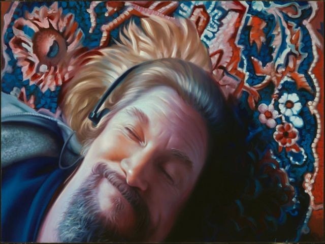

Previous in Blog: Guess the Architecture! 8/11/12   Next in Blog: Guess the Architecture! 9/1/12
21 comments
Guess the Architecture! 8/25/12
Posted August 24, 2012 11:30 PM by Mizuti
Do you recognize this piece of architecture?
Know something about it that others might not?
Do you know a structure that employs a similar style?
Let us know in the comments below!
Re: Guess the Architecture! 8/25/12
08/24/2012 11:35 PM
Re: Guess the Architecture! 8/25/12
08/25/2012 2:19 AM
Habitat '67, Montreal?
Re: Guess the Architecture! 8/25/12
08/25/2012 9:26 AM
Yes is it any wonder this architectural style never caught on, ha, it's looks like a bombed out building....I went to see the "Man and his World" expo, back around '70...
Location: Etherville
Posts: 12362
Re: Guess the Architecture! 8/25/12
08/27/2012 12:54 PM
I love that pic, but please ask admin to resize it. No big deal, but it's too darn large. As ever, you have jumped the shot. Much kuodos.
So far, everybody things its horrid. I like it.
Hobbies - Fishing - Popular Science - Paleontology - New Member
Join Date: May 2008
Location: Holeincanoe Ontario
Posts: 2169
Good Answers: 27
Re: Guess the Architecture! 8/25/12
08/28/2012 7:42 AM
I like it also and more so since I've been in it. Some funky business' and offices alongside an airy living space makes for a residence that still harbours some of the original residents. Navigating the joint can be a tad annoying.
Prophet Freddy has the answer!
Posts: 4362
Good Answers: 179
Re: Guess the Architecture! 8/25/12
08/25/2012 10:38 AM
Tornado nailed it! Habitat from the Expo '67 in Montreal!!!
I've seen this complex several times over the years and it still amazes me to this day....
LUV it!
Join Date: Jun 2008
Location: Kentucky Lake
Posts: 390
Good Answers: 26
Re: Guess the Architecture! 8/25/12
08/25/2012 11:03 AM
I would have guessed the Lego headquarters.
Re: Guess the Architecture! 8/25/12
08/25/2012 9:38 PM
It looks as though Pablo Picasso wangled a housing design project from Albania. One would hope that by now it is covered with ivy, or at least algae, or grafitti, or many colors of paint.
Location: Phnom Penh
Posts: 4019
Good Answers: 102
Re: Guess the Architecture! 8/25/12
08/25/2012 10:52 PM
Inspiration...
Re: Guess the Architecture! 8/25/12
08/26/2012 5:41 AM
Is this what they call Open Architecture?
United States - Member - Charter Member Engineering Fields - Instrumentation Engineering - Charter Member
Join Date: Mar 2008
Location: The People's Republic of Massachusetts
Posts: 1946
Good Answers: 73
Re: Guess the Architecture! 8/25/12
08/26/2012 7:01 PM
It was designed by Moshe Safdie, an Israeli born Canadian.
I go into every human encounter expecting to be framed for a crime I didn't commit. Dilbert, 2013
Location: Phnom Penh
Posts: 4019
Good Answers: 102
Re: Guess the Architecture! 8/25/12
08/26/2012 7:28 PM
..no credits for the civil engineers that had to work out how to build it then?
United States - Member - Charter Member Engineering Fields - Instrumentation Engineering - Charter Member
Join Date: Mar 2008
Location: The People's Republic of Massachusetts
Posts: 1946
Good Answers: 73
Re: Guess the Architecture! 8/25/12
08/26/2012 8:16 PM
All I did was answer a question......
I go into every human encounter expecting to be framed for a crime I didn't commit. Dilbert, 2013
Join Date: Sep 2007
Location: Japan
Posts: 2703
Good Answers: 38
Re: Guess the Architecture! 8/25/12
08/26/2012 8:49 PM
waow the designer was smoking some good stuff when he designed this man!
Join Date: Jun 2010
Location: New York
Posts: 972
Re: Guess the Architecture! 8/25/12
08/27/2012 8:31 AM
I'm curious as to what the inside of one of the rooms looks like, or how one would navigate from room to room. Navigation might be a little awkward unless the hallways get pretty clever inside.
The first law of thermodynamics is you do NOT talk about thermodynamics.
Re: Guess the Architecture! 8/25/12
08/27/2012 4:37 PM
Here's what it looks like inside.
[M.C. Escher, "Relativity"]
Re: Guess the Architecture! 8/25/12
08/28/2012 6:04 AM
It's an early attempt at a stealth building.
Break up the outline keep it low, however the radar signature was too high and it's manoeuvrability was limited.
Shortly after the build they realised the plans were actually for a battleship
Location: Phnom Penh
Posts: 4019
Good Answers: 102
Re: Guess the Architecture! 8/25/12
08/28/2012 8:01 AM
Apart from the aesthetic elements (I will reserve my opinion on that) does this structure claim to have any practical beneficial attributes? Easy intra-building navigation doesn't appear to be one of those.
Is this on prime land?
Posts: 4362
Good Answers: 179
Re: Guess the Architecture! 8/25/12
08/28/2012 9:44 AM
No, it's not on "prime land", but rather it sits on a reclaimed island in the St. Lawrence River.
Location: Phnom Penh
Posts: 4019
Good Answers: 102
Re: Guess the Architecture! 8/25/12
08/28/2012 10:27 AM
If that's the case then it's hit its use-by-date. Needs removal and site rehabilitation.
Sounds like the perfect location for a park.
Posts: 454
Re: Guess the Architecture! 8/25/12
08/28/2012 10:21 AM
It is in a location which experiences cold winters. Given the high surface area relative to volume, it is probably hard to heat, and the aerodynamics are such that it probably whistles in the wind. Oh, well, the architect didn't plan on getting awards for efficiency. There are probably problems of how to clean the windows or how to touch up the paint or stucco or whatever. None of those things count if the tennant values the address more than convenience.
Barchetta (1); Bricktop (2); CaptMoosie (2); Duckinthepond (1); Epke (1); esbuck (1); Kris (1); Mizuti (1); Rixter (1); SolarEagle (2); Tornado (3); user-deleted-1105 (1); Wal (4)
Previous in Blog: Guess the Architecture! 8/11/12   Next in Blog: Guess the Architecture! 9/1/12
