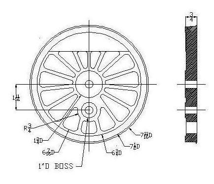

As a builder of 1/8" scale model railroad locomotives, I have need of cutting wood and metal materials, like the spoked drivers for a steam locomotive. These drivers are made from wood. I have a small machine shop, but most of the parts involve cutting wood. There is some metal work required, but that is easily handled. I know there are machines used for commercial applications, like lasers, ultrasonics and high pressure water devices, but they are way too commercial to be used for a hobby like mine.
Is there any way such items as I require can be made easily and quickly. A typical spoked driver is cut from a hardwood, 6" to 10" diameter x 3/4" thick. I have been cutting them out by hand with a fret saw (creating spokes). This is time consumming and the accuracy (repeatability) is not too good.
These models, though large in size, are made to operate by an electric motor, but not to carry a person as in live steam operations. There is a laser machine called "Eplilog" which I have seen, but it is still too pricey for me and is quite slow. There is also an X-Y-Z cutting table that uses a router or a laser head to cut and is computer driven; still quite pricey.
Live steam locomotives can cost many thousands of dollars and many hours to build. I have been able to keep the cost down to under $200. A typical locomotive is 6' long x 12" wide x 12" high and weighs around 60# less batteries. Total weight on the drivers is under 100#. I present this information just so you will have some perspective as to the extent of the task.

First thing that comes to mind: have you considered a metal template and a hand router?
Or a table mounted router and metal template?
Maybe you will have to use thinner wood and glue two pieces together?

Ronseto -- You're one our good guys and deserve some depth of thought on this problem by the rest of us. To that end is it possible for you discuss or illustrate the shape of your drivers and how closely you attempt to replicate the prototype configuration? Or maybe just show a photo of one you have built?
What is the wheel arrangement (number of drivers and lead truck and trailing truck wheels if any) What is the shape of the spokes? Are they tapered or rounded or are they of constant rectangular crossection? Do your drivers have flanges for use on rails of some sort? Is there a hub and axle at the center thicker than 3/4"? Do you have counterweights? Are they just covers over the spokes? (Which would allow the spokes to be all the same length) Do you have crankpin bosses? Are they centered on a spoke or are they between two spokes?
I know something about this and may be able to contribute some specific ideas with a bit more information.

Generally the building of spoked wheels is by assembly of composite structures of many parts. Before we got enthusiastic about CNC as a solution I was going to suggest your looking at this the same way. That is by assembling your wheels your drivers as a glue up assembly of wood parts in a precision fixture. With that in mind you could well start with coming up with a way to make the 72 identical long driver spokes (for 6 drivers) and then extend that thinking to making multiple quantities of the other spokes. A simple CNC routine or even a pantagraph router pattern with adjustable spoke lengths and the same fillets and thicknesses on each end could be worked up. If you start with big table router mechanics much of your hardware could be used when you are ready to replace the pantograph with two stepper motor driven positioning axes and a controlled mechanism for the single movement (cut/no cut) Z axis.
In the interim the building of a large drill jigs for drilling precise locating holes in a lathe turned wheel rim could make a self jigging wheel rim a possibility. Here I'm thinking square black Delrin blocks with the jig hole in the center and 4 screw holes for attachment to a jig plate of Baltic birch plywood. If you're using Forstner drills I'd make steel close fitting sleeves to fit over the forstner drill shank up against the back of the cutting head and about 1/8 larger diameter than the hole to be drilled. Make the matching holes in the square delrin blocks to a nice running fit. This setup will keep the little sharp OD cutting edges of the forstner bit from getting into trouble and damaging themselves or the drill bushing hole.
I think your driver hub would be a separate lathe turned piece and slots for the spokes could be cut on a table or radial saw fixture with a dado blade or even a milling machine if you have one and an indexing fixture with degree plates for the various numbers of spokes you will need.

Hi Ed, I just read your reply. What you propose makes good sense. Time is an issue with us, so a means of accomplishing our tasks in an efficient way is very important. To the younger guys still making a living, a hobby building model trains may seem a friviolus waste of time, energy and resources. At this time in life, I am doing what I love to do and I'm sure others think the same also. Keep in touch. I think we have a lot in common, Ron
